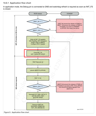

Hi all,
quick question: What happens, if the challenger WD is used, and a bad WD is sent during trying to close the FS_INIT?
There's the WD_ERR_LIMIT, but is it also applied here?
Currently we're seeing a direct assertion of the RSTB pin but want this to be confirmed.
Also regarding debug mode:
Would be behaviour here be identical? Also a instant reset when the wrong WD is sent?
Thank you

TomasVaverka
Hi Andreas,
Yes, if there is no WD refresh or a bad WD refresh is sent during the INIT_FS phase, RSTB pulse is generated, the fault error counter is incremented by 1 and a new initialization phase is automatically started when RSTB is released.
No, in Debug mode, the INIT_FS window is infinite and the WD window is fully opened meaning WD errors are not taken into account.
BR, Tomas
