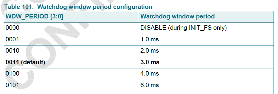

WDW_PERIOD should be configured to 0 during INIT_FS .

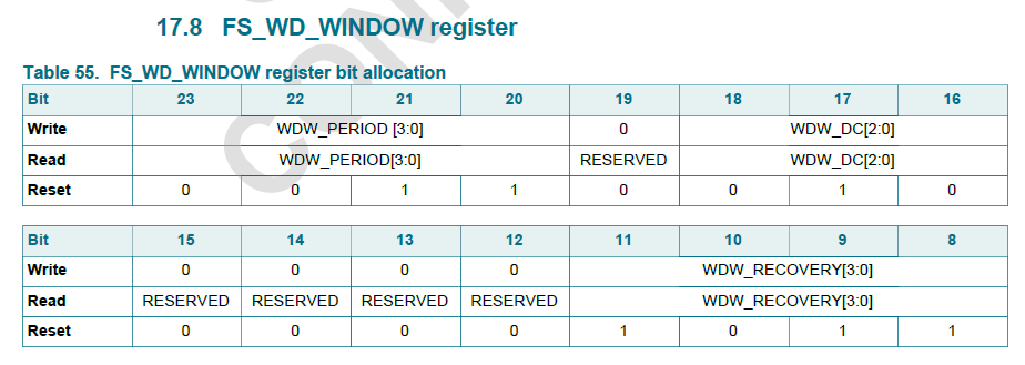

You can send 0x020B  to FS_WD_WINDOW  register in the INIT_FS .
The watchdog configuration requires to write in FS_WD_WINDOW and FS_NOT_WD_WINDOW registers like INIT registers.
