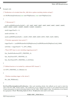

Hi, I am using Sbc_fs26_example project. I realized in the main of this project we do not reload the sbc wdg. I saw SbcWatchdogNotification and i think if i use this i will have to reload the watchdog periodically. But when i added i saw that inside of the function was empty. Is there any example about this which i can use?

the watchdog notification will optionally be call only when the wdg configuration changes, to allow to adapt any custom SW scheduler (triggering the wdg) to stay synchronized. The also included Wdg driver can take care of triggering the watchdog.
There is also example code in the integration manual of the SBC driver
FYI, the Watchdog refresh notification is called after each refresh, to optionally evaluate the flags
best regards
Jochen
