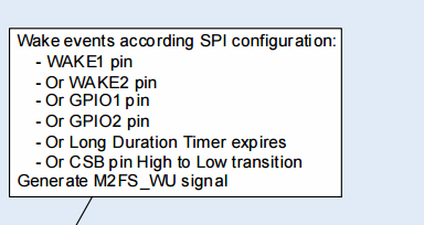

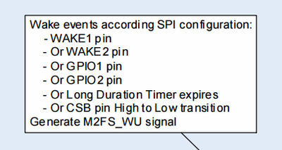

Hi experts,
I currently encounter an issue that FS26 can't be waken up via CSB occasionally.  I use S32K342 and FS26. Only CSB is configured as the wake up source.  So far, there were 5 cases among 1000 sample cars.  After the issue occurred, it could only be recovered after re-connected to the power supply. Till now, I can't reproduce the issue.  When the 3rd case reported, it was suspected that the  M_WIO_CFG was lost abnormally. A robust mechanism was added to check the M_WIO_CFG before instruct FS26 to standby.  Unfortunately it seems that it was not the root cause.  There are 2 questions.
1.  Are there any other case that M_WIO_CFG might be reset?  The only case I can reproduce is that the supply power voltage is dropped to 2v, FS26 is reset and is wake up by default.
2. Are there any other cause that CSB can't wake up FS26?
Thanks.

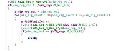

当前MCU每次唤醒后会检查M_WIO_CFG这个寄存器,如果不是期望的,会重新设置,重复3次,进入休眠前也会做同样的检查。

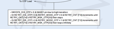

实际只有配置CSB唤醒源。我意思如果真的进入DFS,MCU就不会工作,因为LDO1没有输出了。另外DFS状态下,WAKE1无论有没有配置,都可以触发退出。
1,857 Views
guoweisun
DFS下:
WK1DFS_DIS_OTP = 0 & WAKE1 pin low to high transition
只有WK1DFS_DIS_OTP = 0的情况下WAKE1 L to H 才能唤醒,但是DFS确实没电了power rail.

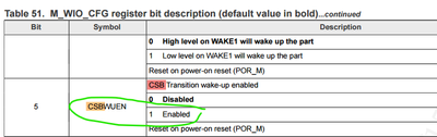

请问你是从哪个状态下唤醒?
唤醒之前CSB_EN enable吗?reset以后这个bit是disable的
2,053 Views
shoubing
1. wakeup from standby mode
2 CSB wakeup is enabled and only CSB wakeup is enable
2,039 Views
guoweisun
你是如何保证在每一次wakeup之前都把CSBWUEN bit设置为了’1‘?
