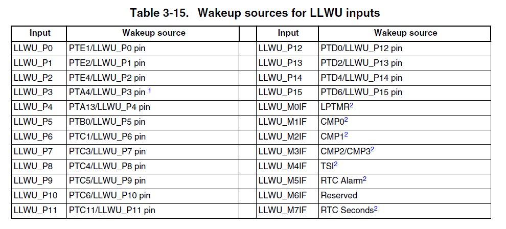

I am working on LLS mode for MK60FN1M0VLQ12 controller.
I configured LLS mode using the example from KINETIS_120_SC TSI_Low_Power but the controller is entering directly to stop mode but not LLS as LPTimer, RTC should work in LLS.
enable_lpwui();
delay(800000);
pee_pbe(CLK0_FREQ_HZ);
pbe_fbe(CLK0_FREQ_HZ);
fbe_fbi(32000,0);
fbi_blpi(32000,0);
enter_lls();
I have attached the file TSI_demo_lowpower.c but I am not using TSI. I want to use LPTimer as Wake up interrupt source. but the issue is when it enters enter_lls(); the LPTimer and RTC have stopped working.

Hi Gangadhar rao,
   How do you find the chip is enter the stop mode, and not the LLS mode?
   Just find the chip can't wake up with LPTMR and RTC, it it right?
   When you use the LPTMR as the wakeup source, do you configure LPTMR modue in the LLUW?
  From your code, I find your LLUW configuration still the TSI, not the LPTMR or RTC, please check this wakupsources for LLWU inputs:
When you use the LPTMR, you must make sure it's clock source can work under LLS mode, you can us ethe 1Khz LPO, it works in LLS mode.
Please configure the LPTMR module, LLUW modue, and enter the LLS mode again.
If you still have question about, please kindly let me know.
Kerry

rajkumar_yerraj
Thank you very much.
I found the issue.
