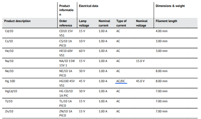

Andrew-Lohmann
Dear Jozef,
I have uploaded the Osram datasheet from their website.  There is also a YouTube video of one of these lamps starting and running on my blog see the link below.
https://blog.andrew-lohmann.me.uk/2018/07/electronics-high-frequency-arc-lamp.html
Thankyou
Andrew

Dear Andrew,
thank you for the datasheet and additional information. I see the spectral lamp type is similar to the fluorescent lamp type.
From the datasheet you shared, you need to supply the Sodium spectral lamp with Alternating Current, so you need an AC/AC controller. Unfortunately we do not have any such type. We have plenty of AC/DC controllers, so we can offer you one for the Mercury type, which is the only one, which can work with both AC and DC current.
Please check this link for our AC/DC controllers portfolio. For the powers from 10W to 60W a flyback type would be more suitable, than the LLC type. For example TEA1755T is suitable for power supplies from 0W to 250W. E.g. the TEA2017 LLC and PFC combo is suitable for powers from 90W to 1000W. For lower powers the LLC controllers have low efficiency.
Regarding the jitter, yes every power supply produces some jitter, but human eye will not be disturbed by that. Current converters works in kHz, latest in MHz. The human eye will not perceive the jitter.
