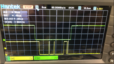

Hi, we are working with the MC33771C, s32k144 and the transceiver MC33664C and we have an issue.
We are using the example project "BCC_S32K144_Monitoring".
The problem occurs in the function "BCC_AssignCid".
When the instruction "status = BCC_Reg_Read(drvConfig, BCC_CID_UNASSIG, MC33771C_INIT_OFFSET, 1U, &readVal);" run, the status give us a "BCC_STATUS_COM_TIMEOUT" because the slave does not recieves response from the MC33771C.

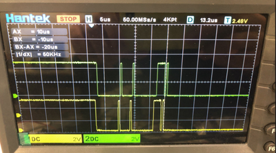

We capture the spi frame in the 'BCC_Reg_Read' in the "BCC_AssignCid" function and we notice that the master data output of the master does not end at '1'. We do not know if this matters..
The green signal is the master clock and the yellow is the master master data output.

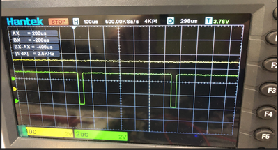

Here, the green signal is the master chip select and the yellow is the master master data output.
Here, the green signal is the serial data input of the slave and the yellow is de serial data output of the master.
The signal recieved in the slave was sent by the transceiver MC33664.
We test the tpl signals of the transceiver MC33664 and works well.

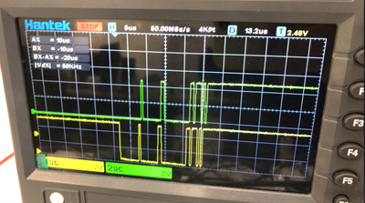

Clarifications:
1. The function BCC_SoftwareReset correctly send the spi frame.
The yellow is the master data output and the green is the slave data input.
2. We have correctly powered the board at 42.1 volts.
3.We are working on tpl mode.

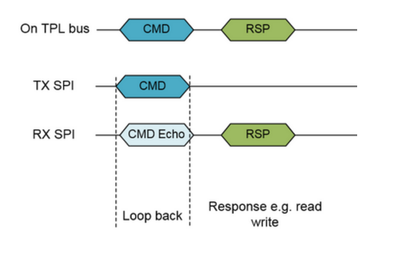

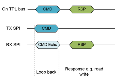

The BCC_Reg_Read() should trigger actually two SPI frames on the RX_SPI of the MC33664 as shown in the picture below.
The CMD would be the Read Request transmitted by the uC.
This CMD Echo is also received on the RX SPI, with a small delay.
Then the MC33771 should respond (RSP) to the Read Request, which should be visible on the RX SPI
Can you see a RSP on the RX SPI?

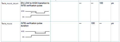

could you please check the following items:
1. prior to the read the following needs to happen:
1.1 the MC33664 needs to be enabled: the uC sets the EN signal and the MC33664 should indicate the INTB as result
1.2 the chain (MC33771) might need to be woken up:
the uC needs to send two short CSB low pulses with a fixed delay between them (note the timing in particular of the pause t2 must be between 500 and 700 us)
1.3 wake-up time of MC33771
after the wake-up pulse (1.2) has been issued a pause of e.g. 1ms should be considered before starting communication.
1.4. if a SW Reset messsage is used
after sending a SW Reset message a delay of >5ms is required before communicating

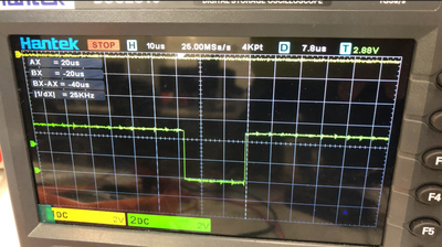

adrimen3668
Hi, we check all the points and still not working.
1.1 the MC33664 needs to be enabled: the uC sets the EN signal and the MC33664 should indicate the INTB as result.
The yellow signal is the ENABLE and the green signal is the INTB.

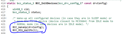

the green signal is the chip select
We put a delay of 1ms after the wake up
Delay of 5 ms after the software reset.

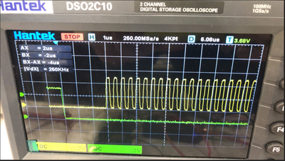

2. check uC TX SPI timing.
In both photos the green signal is the CS_tx and the yellow signal is the CLK_TX.
Any other idea of what the problem could be?
