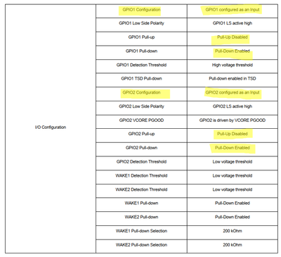

Hi, I'm currently using fs26 pmic with s32k396 evaluation board.
U know, fs26 use spi communication to control several state or pins like gpio, trk1,2 etc
I want to activate gpio 1 pin so I send register command
"Sbc_fs26_WriteRegister(FALSE, 0x11, 0x0318);" - I am using s32ds real time driver.
(I activated gpio1, gpio2, trk1, trk2)
And I read M_STATUS register which can know about fs26 pin state.
But  gpio 1 pin doesnt activated.
Also, I deactivated "Sbc_fs26_WriteRegister(FALSE, 0x12, 0x0318);" - deactivate all pin
But gpio2 pin doesnt deactivated.
So, What I wonder is can't we change gpio1,gpio2 state using spi communication?
According to the datasheet, the VCORE_PGOOD signal is associated with GPIO2.
Is this configuration set as a default when the PMIC device is initially manufactured?
Can't we change status unless using otp configuration?(There are no register address  changing state in s32ds fs26 example code [except gpio high , low] like gpio pull down pull up ) .
thanks. best regards

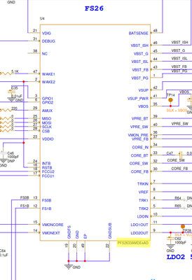

Dear Hyun,
thank you for the product number. According to the schematic, there is FS2633AMDE4AD populated.
According to the FS2633AMDE4AD OTP configuration report attached, the GPIO pins are set as inputs.

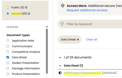

Please check additional software for the S32K396 MCU.
https://www.nxp.com/app-autopackagemgr/automotive-software-package-manager:AUTO-SW-PACKAGE-MANAGER?c...
For enabling the FS26 in OTP mode, please refer to the section 21 in the Full FS26 datasheet. Please download the FS26 product page, under the Secure section.
Please note, you need to have a valid NDA (Non Disclosure Agreement) with NXP to be able to download the FS26 datasheet and other confidential documents.
If you haven't the NDA yet and you would like to sign one, please create a new ticket here and an NXP representative for NDA matters will take you through the process.
