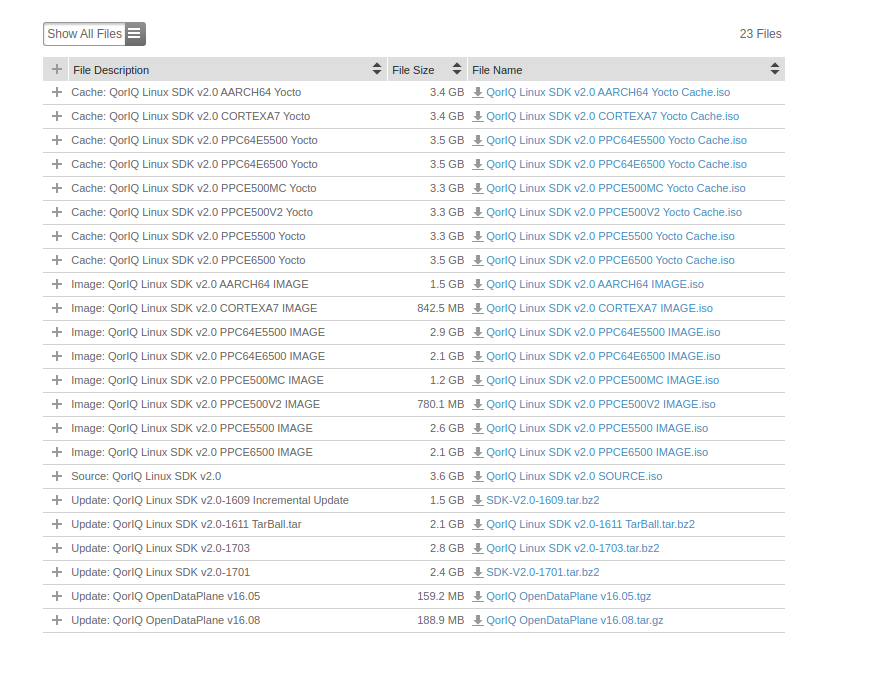

gaolixing
i have  login www.nxp.com,
i don't find QorIQ-SDK-V2.0-SOURCE-20160527-yocto.iso and Cache ISO QorIQ-SDK-V2.0-PPCE500MC-CACHE-20160527-yocto.iso
4,760 Views
yipingwang
Please download
"QorIQ Linux SDK v2.0 SOURCE.iso" and
"QorIQ SDK V2.0 PPCE500MC Yocto CACHE.iso"
4,760 Views
gaolixing
thank you,but where can i download  ISO QorIQ-SDK-V2.0-SOURCE-20160527-yocto.iso and Cache ISO QorIQ-SDK-V2.0-PPCE500MC-CACHE-20160527-yocto.iso? i don't find them at Linux® SDK for QorIQ® Processors | NXP
4,760 Views
yipingwang
Please login www.nxp.com, then click "Download" from the above link.

gaolixing
thanks for your reply,but QorIQ Linux SDK 2.0 release, which could be downloaded from Linux® SDK for QorIQ® Processors | NXP can't be compiled because www.freescale.com is shut down,which yocto verison support both
p4080ds and USDPAA
4,760 Views
yipingwang
Hello lixing gao,
Yocto 3.0 release doesn't support USDPAA, you could use QorIQ Linux SDK 2.0 release, which could be downloaded from Linux® SDK for QorIQ® Processors | NXP .
Yiping
