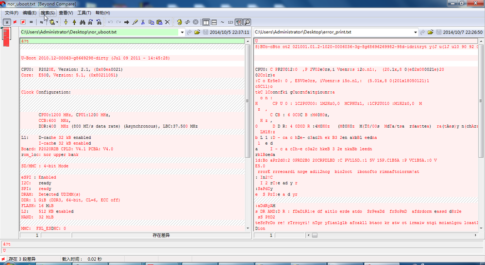

I flash burned the 16MB P2020RDB-PCA nor flash bin to my own designed P2020 board's nor flash!
the uboot print is stange,character out of order. please help!
the prints are as followes
U
8)BUo-oBto ot2 021001.01.2-1020-0006036-3g-8g68696269982-98d-idritryt y(J u(lJ ul0 90 92 02101 1-1  1-4 1:44:54:52:82)
CPU0: C PP2U012:0  ,P 2V02e0rs,i Voenr:s i2o.n1:,  (20.1x,8 0(e02x080021e)20
02Co1r)e
:C o Er5e0: 0 , E5V0e0rs, iVoenr:s i5o.n1,:  (5.01x,8 0(201x18050121)1
c5C1l)o
tkC lCooncfki gCuornfaitgiounr:a
  o n :
H      CP U 0 : 1C2P0U00: 1M2Hz0,0  MCPHUz1, :1CP2U010 :M1H2z0,0  M
z  ,
      C CB : 6 0C0C B :M60H0z,
  H z ,
0      D D R: 4 0D0D R :4M0H0z   (M80H0z  M(T8/00s  MdTa/tsa  rdaattea)  ra(tAes)y n(chArsoynnocuhrso)n,o LuBs)C,: 37L.BC5:0307 .M5H0z
  LM1H:z
b L 1  - ca c hDe- c3ac2h ek B3 2en akbBl eedna
l  e d
a     I - c a cIh-e c3a2c hkeB 3 2e nkaBb leedn
rblBoeda
1d:Bo aPr2d0:2 0PRD2B0 20CRPDLBD :C PV1L5D.:1 5V 15P.C1B5A  VC1B5A.:0 V
E5.0
rrorE rrreoardi nrge adii2ncg  bio2oct  ibonofto rimnaftoiornm!at
: In2!C
  I 2 rC:e ad y r
:SaPdIy
e  S PrI:e a d yr
:aDdRyAM
s DR AMD:D R : fDaDiRl:e df aitlo erde atdo  SrPeaDd  frSoPmD  afdrdorm eassd d8r2e
sS P8D2
teSrPrDo re! rTrroyri! nTgr yfianlglb afcakll btaoc kr atw ot irmaiw ntgi mcianlgcu lcaatlciuolna
Dion
MetecDteetde UcDtIeMdM U(DsI)M
(s)
CDR: 1 GiDDBR  D1DR G3,i B 64(-DbDiR3t,,  6CL4=-b6i,t E,C CCL =o6f,f )E
C off)
r=ASHB:a d trap at PCE:R RO3Rf:f 3t1o7o0c ,m aSnRy: f l2a1s2h0 0s, evcetcotros
M 3d200
iNBI
0:L 23: F F 31 7501C2  XKBE R:e n2a0b0le0d0
00 LR: 3FF3857C REGS: 3fe2de20 TRAP: 0d00 DAR: FFD00000
MSR: 00021200 EE: 0 PR: 0 FP: 0 ME: 1 IR/DR: 00
GPR00: 00076E00 3FE2DF10 3FE2DF44 FFD00000 00000200 EF00000A EF000015 00000000
GPR08: 0000000A 3FFB0008 00000001 3FE2DF10 3FFA2000 0A825088 200CC281 4FFB0000
GPR16: 44299801 C2400848 6A191201 99F40A40 00001000 3FE2DE10 00000000 3FF3109C
GPR24: 3FF353F4 4A2D8448 3FE2DF2C 3FE2DF44 3FF30000 3FF30000 3FFA240C 3FE2DFB8
Call backtrace:
3FF38568 3FF31644 01108122
Exception in kernel pc 3ff3170c signal 0
### ERROR ### Please RESET the board ###

Hello Li Tian,
Have you verified CodeWarrior bareboard sample project? Could the word "Welcome to CodeWarrior!" be printed normally from the serial console? CodeWarrior uses UART1 by default.
Yiping
