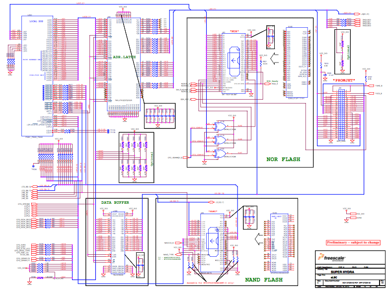

Ignoring the point about why not to use LA31, freescale Superhydra board has a 1 Gb NOR memory, which have 16 memory address bits and 10 memory sector bits, so this is 26 address lines. As you have told me, you have to use LA05..LA30, I guess the 16 LSB are the memory address and the other 10, the sector address. Why LA7..LA5 are not connected directly to the NOR but controlled? what these signals mean?Screen Shot 2017-05-10 at 12.50.11.png

On P5040Ds board upper address lines LA7..LA5 are used to create "virtual banks", to do that these lines are connected through XOR gates controlled by CPLD. This is to have a possibility to invert upper 3 address lines if necessary.
Yes, data bus numbering is also opposite - LAD0 is most significant data bit. Also, data lanes should be connected as described in P5040 Reference Manual, Table 13-2:
