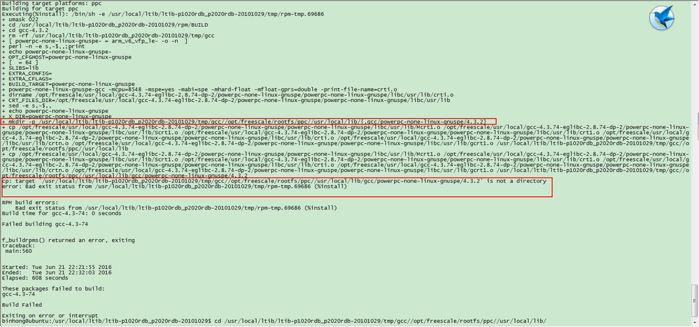

With the Ubuntu14.04 and 10.04, I use the ltib to build p2020rdb, but it appeared error like this:
Processing: gcc-4.3-74
Build path taken because: directory build, build key set, no prebuilt rpm,
rpmbuild --dbpath /usr/local/ltib/ltib-p1020rdb_p2020rdb-20101029/rootfs//var/lib/rpm --target ppc --define '_unpackaged_files_terminate_build 0' --define '_target_cpu ppc' --define '__strip strip' --define '_topdir /usr/local/ltib/ltib-p1020rdb_p2020rdb-20101029/rpm' --define '_prefix /usr' --define '_tmppath /usr/local/ltib/ltib-p1020rdb_p2020rdb-20101029/tmp' --define '_rpmdir /usr/local/ltib/ltib-p1020rdb_p2020rdb-20101029/rpm/RPMS'  --define '_mandir /usr/share/man' --define '_sysconfdir /etc' --define '_localstatedir /var' -bi --short-circuit  /usr/local/ltib/ltib-p1020rdb_p2020rdb-20101029/tmp/gcc-4.3-74.spec
Building target platforms: ppc
Building for target ppc
Executing(%install): /bin/sh -e /usr/local/ltib/ltib-p1020rdb_p2020rdb-20101029/tmp/rpm-tmp.73320
+ umask 022
+ cd /usr/local/ltib/ltib-p1020rdb_p2020rdb-20101029/rpm/BUILD
+ cd gcc-4.3.2
+ rm -rf /usr/local/ltib/ltib-p1020rdb_p2020rdb-20101029/tmp/gcc
+ [ powerpc-none-linux-gnuspe- = arm_v6_vfp_le- -o -n  ]
+ perl -n -e s,-$,,;print
+ echo powerpc-none-linux-gnuspe-
+ OPT_CFGHOST=powerpc-none-linux-gnuspe
+ [  = 64 ]
+ SLIBS=lib
+ EXTRA_CONFIG=
+ EXTRA_CFLAGS=
+ BUILD_TARGET=powerpc-none-linux-gnuspe
+ powerpc-none-linux-gnuspe-gcc -mcpu=8548 -mspe=yes -mabi=spe -mhard-float -mfloat-gprs=double -print-file-name=crti.o
+ dirname /opt/freescale/usr/local/gcc-4.3.74-eglibc-2.8.74-dp-2/powerpc-none-linux-gnuspe/powerpc-none-linux-gnuspe/libc/usr/lib/crti.o
+ CRT_FILES_DIR=/opt/freescale/usr/local/gcc-4.3.74-eglibc-2.8.74-dp-2/powerpc-none-linux-gnuspe/powerpc-none-linux-gnuspe/libc/usr/lib
+ sed -e s,-$,,
+ X_DIR=powerpc-none-linux-gnuspe

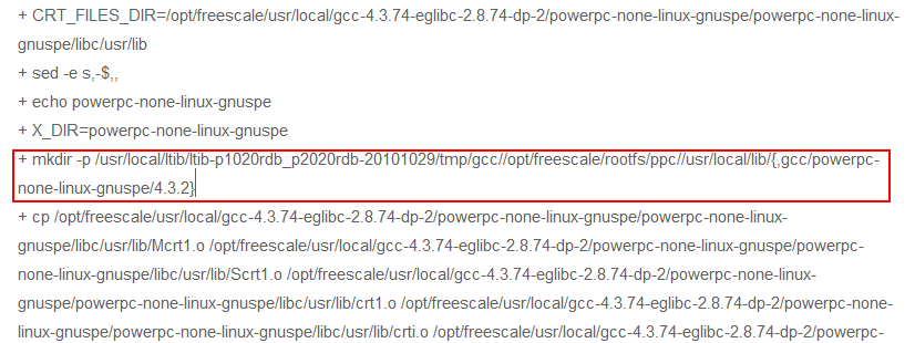

+ mkdir -p /usr/local/ltib/ltib-p1020rdb_p2020rdb-20101029/tmp/gcc//opt/freescale/rootfs/ppc//usr/local/lib/{,gcc/powerpc-none-linux-gnuspe/4.3.2}
+ cp /opt/freescale/usr/local/gcc-4.3.74-eglibc-2.8.74-dp-2/powerpc-none-linux-gnuspe/powerpc-none-linux-gnuspe/libc/usr/lib/Mcrt1.o /opt/freescale/usr/local/gcc-4.3.74-eglibc-2.8.74-dp-2/powerpc-none-linux-gnuspe/powerpc-none-linux-gnuspe/libc/usr/lib/Scrt1.o /opt/freescale/usr/local/gcc-4.3.74-eglibc-2.8.74-dp-2/powerpc-none-linux-gnuspe/powerpc-none-linux-gnuspe/libc/usr/lib/crt1.o /opt/freescale/usr/local/gcc-4.3.74-eglibc-2.8.74-dp-2/powerpc-none-linux-gnuspe/powerpc-none-linux-gnuspe/libc/usr/lib/crti.o /opt/freescale/usr/local/gcc-4.3.74-eglibc-2.8.74-dp-2/powerpc-none-linux-gnuspe/powerpc-none-linux-gnuspe/libc/usr/lib/crtn.o /opt/freescale/usr/local/gcc-4.3.74-eglibc-2.8.74-dp-2/powerpc-none-linux-gnuspe/powerpc-none-linux-gnuspe/libc/usr/lib/gcrt1.o /usr/local/ltib/ltib-p1020rdb_p2020rdb-20101029/tmp/gcc//opt/freescale/rootfs/ppc//usr/local/lib
+ cp /opt/freescale/usr/local/gcc-4.3.74-eglibc-2.8.74-dp-2/powerpc-none-linux-gnuspe/powerpc-none-linux-gnuspe/libc/usr/lib/Mcrt1.o /opt/freescale/usr/local/gcc-4.3.74-eglibc-2.8.74-dp-2/powerpc-none-linux-gnuspe/powerpc-none-linux-gnuspe/libc/usr/lib/Scrt1.o /opt/freescale/usr/local/gcc-4.3.74-eglibc-2.8.74-dp-2/powerpc-none-linux-gnuspe/powerpc-none-linux-gnuspe/libc/usr/lib/crt1.o /opt/freescale/usr/local/gcc-4.3.74-eglibc-2.8.74-dp-2/powerpc-none-linux-gnuspe/powerpc-none-linux-gnuspe/libc/usr/lib/crti.o /opt/freescale/usr/local/gcc-4.3.74-eglibc-2.8.74-dp-2/powerpc-none-linux-gnuspe/powerpc-none-linux-gnuspe/libc/usr/lib/crtn.o /opt/freescale/usr/local/gcc-4.3.74-eglibc-2.8.74-dp-2/powerpc-none-linux-gnuspe/powerpc-none-linux-gnuspe/libc/usr/lib/gcrt1.o /usr/local/ltib/ltib-p1020rdb_p2020rdb-20101029/tmp/gcc//opt/freescale/rootfs/ppc//usr/local/lib/gcc/powerpc-none-linux-gnuspe/4.3.2
cp: target '/usr/local/ltib/ltib-p1020rdb_p2020rdb-20101029/tmp/gcc//opt/freescale/rootfs/ppc//usr/local/lib/gcc/powerpc-none-linux-gnuspe/4.3.2' is not a directory
error: Bad exit status from /usr/local/ltib/ltib-p1020rdb_p2020rdb-20101029/tmp/rpm-tmp.73320 (%install)
RPM build errors:
Build time for gcc-4.3-74: 0 seconds
Failed building gcc-4.3-74
f_buildrpms() returned an error, exiting
traceback:
main:560
Started: Tue Jun 21 12:39:26 2016
Ended:   Tue Jun 21 12:49:33 2016
Elapsed: 607 seconds
These packages failed to build:
gcc-4.3-74
Build Failed
Exiting on error or interrupt

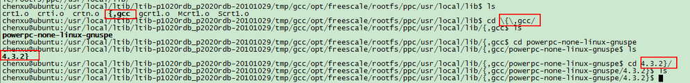

when i check the path, i found :
as
Who had the same problem? and how to solve this problem?

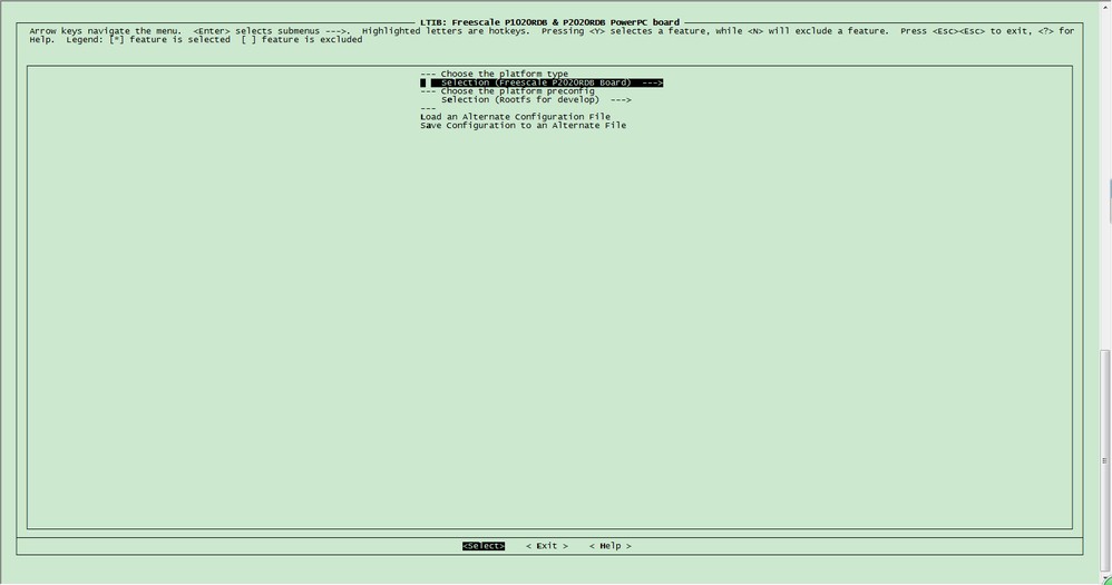

xuchen
Hello dear Pavel,  my question is:
I can install ltib success, when first run ./ltib, the default platform type is P1020 RDB board, I can build success with the platform of P1020 RDB board, but I want to choose the platform type of P2020RDB, the problem  appeared.
