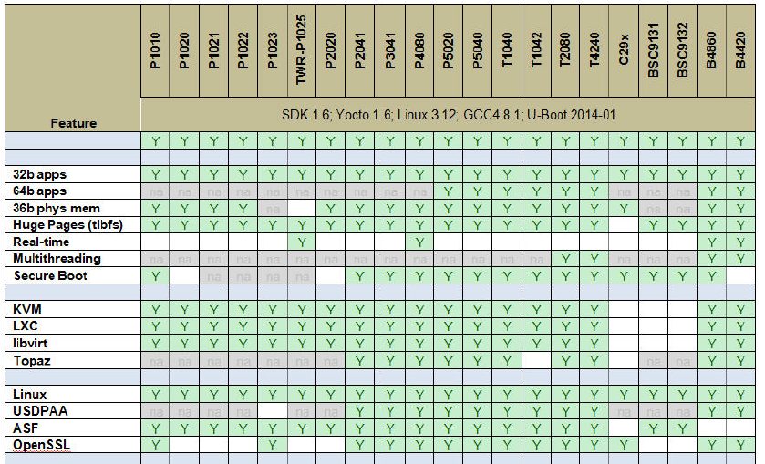

I have downloaded V1.6 SDK. Selected "p1020rdb" as machine type. Trying to do "bitbake usdpaa". I get the following:
ERROR: Function failed: do_compile (log file is located at
/home/sratliff/mySDK/QorIQ-SDK-V1.6-20140619-yocto/build_p1020rdb_release/tmp/work/p1020rdb-
fsl-linux-gnuspe/usdpaa/git-r0/temp/log.do_compile.14919)
ERROR: Logfile of failure stored in:
Log data follows:
| DEBUG: Executing shell function do_compile
| NOTE: make CC=powerpc-fsl-linux-gnuspe-gcc  -m32 -mcpu=8548 -mabi=spe
-mspe -mfloat-gprs=double
--sysroot=/home/sratliff/mySDK/QorIQ-SDK-V1.6-20140619-
yocto/build_p1020rdb_release/tmp/sysroots/p1020rdb
LD=powerpc-fsl-linux-gnuspe-ld
AR=powerpc-fsl-linux-gnuspe-ar
|  [CC] fmc_netcfg_parser.c (lib:usdpaa_syscfg)
| apps/lib/fmc_netcfg_parser.c:1:0: error: SPE not supported in this
| target
|  /* Copyright (c) 2010-2012 Freescale Semiconductor, Inc.
| make: *** [apps/lib/objs_powerpc/usdpaa_syscfg_fmc_netcfg_parser.o]
Error 1
| ERROR: oe_runmake failed
| WARNING:
fsl-linux-gnuspe/usdpaa/git-r0/temp/run.do_compile.14919:1
exit 1 from
|   exit 1
ERROR: Task 6
(/home/sratliff/mySDK/QorIQ-SDK-V1.6-20140619-yocto/meta-fsl-ppc/recipes-
dpaa/usdpaa/usdpaa_git.bb,
do_compile) failed with exit code '1'
NOTE: Tasks Summary: Attempted 660 tasks of which 619 didn't need to be rerun and 1 failed.
Waiting for 0 running tasks to finish:
Does the p1020 support USDPAA? I'm a Freescale "newbie", but I've been told when the kernel is compiled for use, CFLAGS are set (in part) to  "-mno-spe -mspe=no -te500v2".
That sort-of looks like SPE is not supported???
Any help/pointers appreciated.

For the  question "Does the p1020 support USDPAA", I am afraid not.  See below table(partly) of features supported by each processor.

Hello Stanley Ratliff,
P1020 doesn't support USDPAA, "usdpaa" is only supported on QorIQ DPAA(Data Path Acceleration Architecture) platforms, such as P2041, P3, P4, P5, and T series, there is build limitation in Yocto build environment.
In SDK 1.6 Yocto build environment, before build Kernel "CFLAGS" is unset. Please refer to the following.
kernel_do_compile() {
        unset CFLAGS CPPFLAGS CXXFLAGS LDFLAGS MACHINE
        oe_runmake uImage  CC="powerpc-fsl-linux-gnuspe-gcc  --sysroot=..." LD="powerpc-fsl-linux-gnuspe-ld.bfd  --sysroot=..."
If you want to build usdpaa, you could choose other platform which I mentioned above, for example p4080ds, and you need to install source ISO and e500mc Cache ISO.
