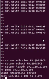

We have designed P2041 processor based custom design board.
We are using RGMII ETHERNET ports through PHY VSC8572 which can support two RGMII ports on a single chip.
RGMII 0 port is working fine at all speeds.
But for RGMII 1 port, we are able to see its "alive" in uboot in both loopback and communication path.
But when we try to ping at the kernel level with other PC, we are unable to ping and gives message "Destination Host  Unreachable" at all speeds (10/100/1000 Mbps).
We are using Yocto OS suggested for this processor.
We are unable to fix tis issue since we are trying from last few weeks.
Please support us ASAP to get out of this problem.

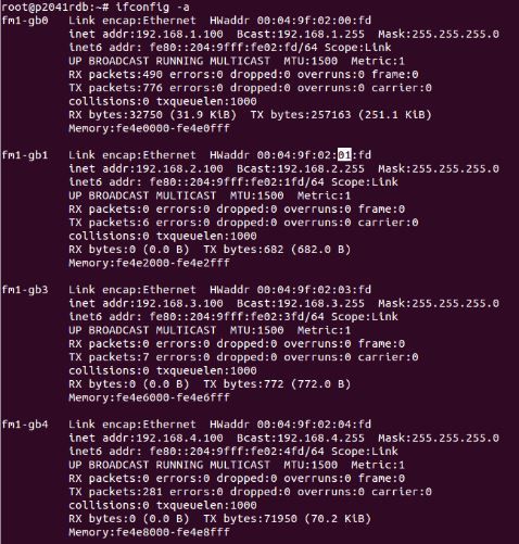

     The Kernel Ping Log shows only Destination Host Unreachable
1,102 Views

In the image, it is shown as mii write 0x05 0x00 0x5040 which is for testing PHY in software loopback. But mii write 0x05 0x00 0x1040 is for communication with other PC.
This meant that it is alive in both loopback and on communication in the uboot.
Avinash

1) Provided U-Boot log does not match with the previous picture.
2) There is no ping log
1,102 Views

1. U-Boot log showing ping through the RGMII 1:
mii write 0x05 0x1f 0x0010
mii write 0x05 0x13 0x800f
mii write 0x05 0x1f 0x0000
mii write 0x05 0x18 0x2041
mii write 0x05 0x12 0x00a8
mii write 0x05 0x1f 0x0002
mii write 0x05 0x12 0x000e
setenv ethprime FM1@DTSEC5
setenv ethact FM1@DTSEC5
setenv ipaddr 192.168.20.1
ping 192.168.20.2
----then result is host 192.168.20.2 is alive where 192.168.20.2 is other PC communicating to my device.
2. log of the 'ifconfig -a' and the ping in Linux:
fm1-gb3   Link encap:Ethernet  HWaddr 00:04:9f:02:03:fd
          inet addr:192.168.3.100  Bcast:192.168.3.255  Mask:255.255.255.0
          inet6 addr: fe80::204:9fff:fe02:3fd/64 Scope:Link
          UP BROADCAST MULTICAST  MTU:1500  Metric:1
          RX packets:0 errors:0 dropped:0 overruns:0 frame:0
          TX packets:11 errors:0 dropped:0 overruns:0 carrier:0
          collisions:0 txqueuelen:1000
          RX bytes:0 (0.0 B)  TX bytes:1058 (1.0 KiB)
          Memory:fe4e6000-fe4e6fff
fm1-gb4   Link encap:Ethernet  HWaddr 00:04:9f:02:04:fd
          inet addr:192.168.4.100  Bcast:192.168.4.255  Mask:255.255.255.0
          inet6 addr: fe80::204:9fff:fe02:4fd/64 Scope:Link
          UP BROADCAST RUNNING MULTICAST  MTU:1500  Metric:1
          TX packets:92 errors:0 dropped:0 overruns:0 carrier:0
          RX bytes:0 (0.0 B)  TX bytes:22054 (21.5 KiB)
          Memory:fe4e8000-fe4e8fff

Please provide:
1) U-Boot log showing ping through the RGMII 1 port
2) DTS being used
3) log of the 'ifconfig -a' and the ping in Linux
1,102 Views

ufedor
Please provide textual logs - not pictures.
