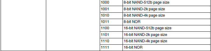

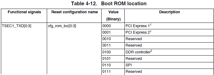

Hello Brad Duncan,
What do you mean by this?
If you are asking for boot ROM location, this is specified in Table 4-12 Boot ROM location in P1010RM.pdf, Rev.3 as belowpastedImage_0.pngpastedImage_1.png
Lunmin
1,576件の閲覧回数
scottwood
I believe he's asking for the boot rom source code.
