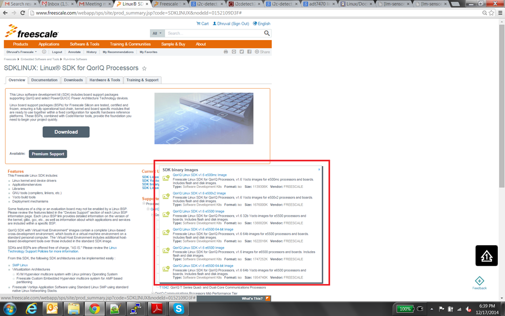

I went to this link and found that there are multiple options and version for download. I have captured the screen shot for the same and here it is: Please look into the red box. I am confused that out of all these images which image/sdk package that I should choose for working on P2020RDB board on Big Endian mode?
Also what is the Yocto? I am not familiar with it so it will be great if you can help me understand the same.
Really appreciate your help!
Dhruval

lunminliang
As P2020 is E500v2 implementation, you'll need QorIQ Linux SDK v1.6 e500v2 Yocto Cache and QorIQ Linux SDK V1.6 Yocto Source ISO
The source ISO contains the package source tarballs and yocto recipes. It can be installed and used to do non-cache build.
About 8 hours are needed to finish the process of non-cache build on a normal computer with two cores. The cache ISO contains the prebuilt cache binaries. To avoid a long time build,you can install the source ISO and the cache ISO in the same installation folder.
The Yocto Project is an open source collaboration project that provides templates, tools and methods to help you create custom Linux-based systems for embedded products regardless of the hardware architecture. See more here https://www.yoctoproject.org/about
