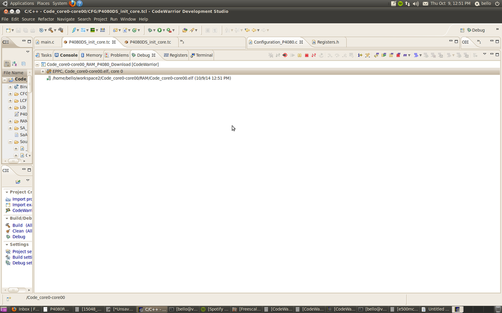

hymalaibello
Hi!
I need to disable only one of the DDR controller, but the program stops.  In the configuration of the CPC as SRAM  Interleaving is disabled. But in the Init_core file, the LAW configuration of DDR 0x8140001E so, that mean that  the interleaving mode in DDR is enabled, but when I try to disable it says Error Writing memory in the debug.
Thanks!
Regards!
Hymalai Bello

hymalaibello
Hi!
This is a resume of the Init-core
#LAW31 to DDR - 2GB
mem [CCSR 0xDF0] = 0x00000000
mem [CCSR 0xDF4] = 0x00000000
# Interleaved mode
mem [CCSR 0xDF8] = 0x8140001E
# DDR1_DDR_SDRAM_CFG
mem [CCSR 0x8110] = 0x470C0000
# DDR1_CS0_CONFIG
mem [CCSR 0x8080] = 0x80014202 # Interleaving Disable
# DDR1_CS1_CONFIG
mem [CCSR 0x8084] = 0x80014202
# DDR1_CS2_CONFIG
mem [CCSR 0x8088] = 0x80014202
# DDR1_CS3_CONFIG
mem [CCSR 0x808C] = 0x80014202
# DDR1_CS0_BNDS
mem [CCSR 0x8000] = 0x0000001f
# DDR1_CS1_BNDS
mem [CCSR 0x8008] = 0x0020003f
# DDR1_CS2_BNDS
mem [CCSR 0x8010] = 0x0040005F
# DDR1_CS3_BNDS
mem [CCSR 0x8018] = 0x0060007F
mem [CCSR 0x8110] = 0xC70C0000
# DDR2_DDR_SDRAM_CFG
mem [CCSR 0x9110] = 0xC70C0000
the same configuration is done for DDR2
And when I debug, I cannot run the main.
Thanks!
Hymalai Bello
