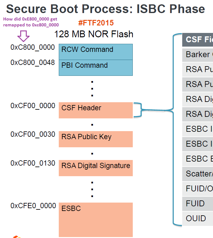

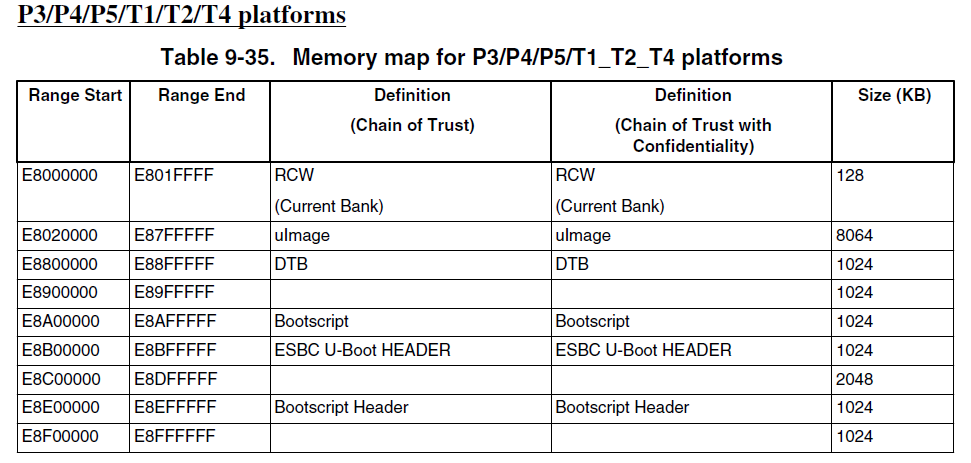

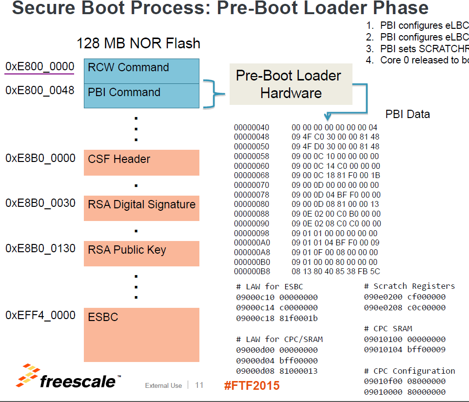

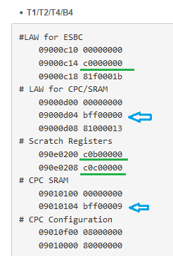

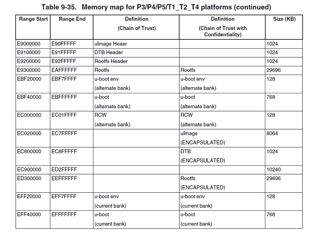

marcboillot
Hi. from the illustrations above, the LAW for ESBC is at C000000 and the SCRATCH pointers are also in the C0xxxxxx address space. OK, this is the address range to be in the 0-3.5GB space for secure boot requirements (<D0000000), and this is where we would like to have uBoot and ESBC Header, yes? However, the ESBC Header and uBoot are actually physically in NOR at EBF40000 and EFF4000 which is beyond the 0-3.5GB (0-D0000000) address space, yes?
Question: So how can ISBC find uBoot header at EBF4000 and uBoot at EFF4000 by way of the PBI commands above that initialize the LAW ESBC in C0000000? Are additional commands required to copy uBoot & Header from NOR into the lower C0000000 address space, or does the LAW ESBC PBI command somehow map one-to-one with the NOR memory map (starting at E8000000)? In short, how are those PBI commands above referencing any access to the UBoot and Header in NOR that ISBC needs to find?
Are additional steps required? for example, more PBI commands to place uBoot and header in the CPC? But isnt the CPC fixed to BFF00000? The LAW for CPC/SRAM its address bff00000, it is configured in the later CPC SRAM and CONFIG PBI commands (blue font). But how did NOR get remapped from 0xE800xxxx to 0xC800xxxx, if the CPC is already configured (for use with the House Keeping area with ISBC)? Code Warrior can confirm the images in 0xE8000 shown the first slide below. But, how does one change the system map to make NOR appear in the lower C8000000 address space?
Thank you

marcboillot
Hi.
Thank you for the prompt reply, however, the post does not relate or answer the question asked, or at least, help to solve the problem we have. Could you please elaborate the context of your response (e.g., what does PAMU have to do with the PBI commands, or key hash; these seem entirely unrelated to our post)? Can you please review the question we posted with the accompanied Freescale slides and specifically help us understand or explain why NOR XIP flash is in the E000_0000+ range, but any uboot or header images in this space will not be recognized by the ISBC because it exceeds the 0-3.5GB address space (0 t0 D000_000), and how to configure the PBI commands to read uBoot in this lower 0-3.5GB range, or otherwise map the address spaces. I posted specific Freescale images that show how NOR flash is in E000_0000 address then all of a sudden (without explanation) it appears in the next slide as C000_0000 address space. The PBI commands shown are pointing to the 0xC000_xxxx regions yet the images are in 0xE000_xxxx locations. We would be very appreciative if we could receive answers to the specific questions posted.

marcboillot
NXP answered this in a recent email: The address mapping to 0xe000000 happens in the boot code where the IFC controller and the LAW is configured to map NOR flash to this address.  Before this when Boot Rom comes into the picture, we configure the LAW for the IFC in such a way that same NOR flash maps to 0xC000_0000  which explains why the PBI commands for LAW and SCRATCHRW are in the 0xCxxxxxxx instead of the NOR address space of 0xExxxxxxxx.  Thank you
