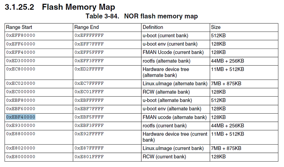

The QorIQ_SDK_Infocenter.pdf document within the install has information on the flash bank usage for the current SDK. Make sure you use the document and flash map from the current SDK, as things change. I ended up with a system that didn't boot when I used the older location for the fman uCode (from SDK 1.x) on the SDK 1.3.2 system. Here is a table from the document that shows the flash map for a couple of the QorIQ DS system.
It's important to note here that this covers the NOR flash - which is what I'm currently using. You may want to experiment with using NAND or SPI based flash instead - but for my purposes I'm going to re-image NOR flash.
The NOR on these development systems is banked, meaning that the most significant address line is tied to a DIP switch. So I can have multiple images in Flash at one time, and switch between them (especially helpful when I mistakenly corrupt one).
I'm currently in bank0 (which is the "current bank" in the table above). From this, I see that the addresses I should be interested in are located at:

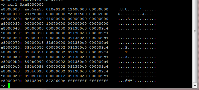

To verify that this is correct, I can dump out my RCW:

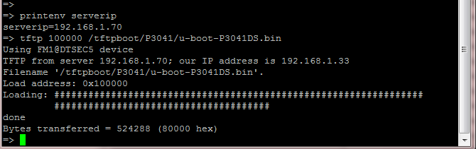

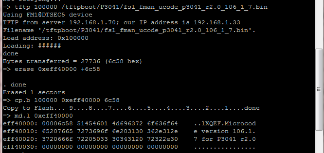

at this point I can start updating the images directly from my TFTP server. I have my tftp server already defined via the U-boot environment serverip, so I just tftp the U-boot image to a randomly picked address in RAM of 0x100000.

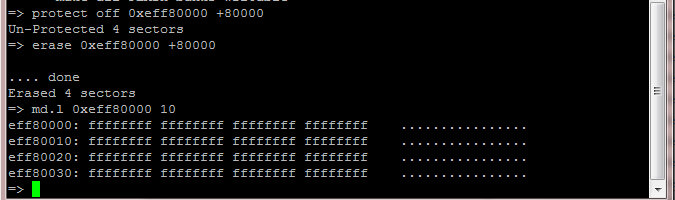

The transfer went ok, so I can burn it into flash now. I will first erase the flash starting at 0xeff80000. Since U-boot is 0x80000 size, I'll erase from 0xeff80000 for size 0x80000.
Apparently my sectors were protected. So I need to unprotect first, then erase again.
And by reading the flash, I verify that it has been erased (erased NOR always reads back all 0xF's)

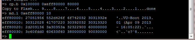

So, now I can burn the flash:
I use a binary copy. And then verify that the image was written correctly.
Then we go through the same technique with the other images. I'll burn the fman ucode as well:

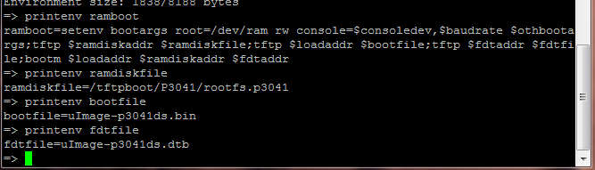

Then for the actual images and dtb, you have an option of burning them, but I'll tftp them instead. For this I created a U-boot environment variable called ramboot, and point the image names to the paths on my server:
At this point I can save the environment to flash via a saveenv command in U-boot. I'll re-boot into the new U-boot to make sure it works (if it doesn't for some reason, I can jump back to a different U-boot I had previously burned in the alternate bank, or else I'll have to use a debugger to re-burn the flash).
Then, from within U-boot I can run ramboot, and if all goes well it should fetch the images and boot all the way into the new SDK.
