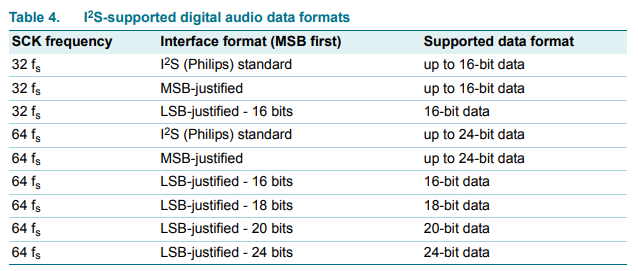

Hello Matt,
My colleague has tried the exact same sequence on the demo board, without any issues.
The problem is in the SCK1 and LRCK1 frequencies.
Using I2S format the TFA9879 does not support 96*Fs ratio. Supported formats are 32*Fs and 64*Fs. See below.
If you would like to make it work, then SCK1 needs to run at 64*LRCK1.
Furthermore the audio format you are sending is 16bit per channel, so if running at 64*Fs make sure that the 16 LSB’s per channel are filled by 0’s.

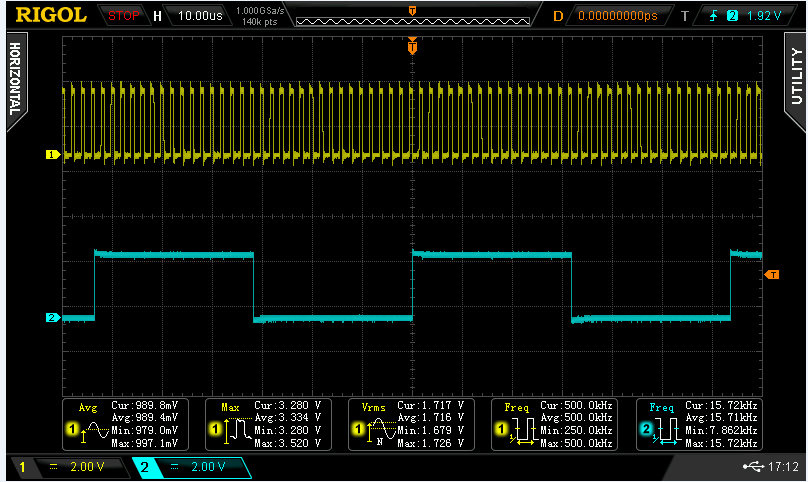

Thanks for the reply.  Can you point me to the demo board?  I tried finding one myself but had no luck, so I'm using a breakout board.  If the demo board works then we can just use that layout for our product.
Using my own breakout board, I changed my timings and it's currently running 32:1 (500kHz SCK, 15.7kHz LRCK, so 31.8:1) and the problem persists, see my scope screenshot below.  At low volumes the sound is very clear, the problem is that I get very little volume before it starts to break up.  Does your dev board run the amp at 5V?
