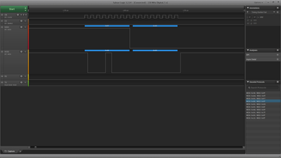

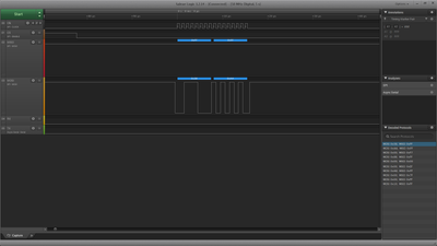

Hi forks,
In our company we are using sc16is752 as an spi bridege to rs232. I am writing data into the scr registor but while reading it back i am not able to get the same data back from the registor. I am using digital  osciloscope for that. I am sending the data to the sc16is752  from the nxp imx6q based som. The chip select signal is also changes the state during the data transfer. i have attached the screenshots. Please have a look into it. Thanks.
CS issues:
Writing the data to the spr registor:
Reading the spr registor back:

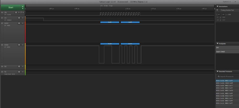

farooq
3.JPGHi fork
