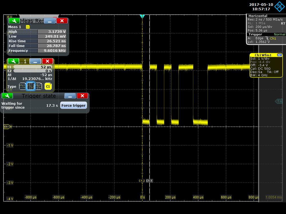

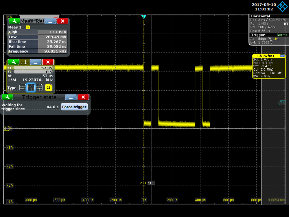

We have repeated the testing. It looks that you are correct on the possible impact of BRK on autobaud.
We monitored the input signals with a scope.
It looks that UCC7 did declare the reception of bytes and BRKs that were not sent by DCE at all (confirmed with scope), although we did not see any un-expected BRK or un-expected  characters  to UCC7 Rx through the scope.
For example,
  • one byte (0x35,  for  ‘5’ ) from DCE was declared at UCC7 as three Rx events with bytes 0x1c 0xfc 0xfc. (see Test Case Group 1)
  • one byte (0x41,  for ‘A’) from DCE was declared at UCC7 as one  Rx event with byte 0x1c and a BRK event (see Test Case Group 2)
 It was found in the following two group of test cases that
  • a specific set of  characters seems to always  trigger correct BRGC baud rate locking (Test Case Group 1), and
  • an another specific set of  characters (Test Case Group 2) always  trigger incorrect BRGC baud rate locking.   In these cases, the un-existing BRKs from DCE were always reported by UCC7 UCCE register.
-------Test Case Group 1:   (correct baud locking cases, no BRKs)
DCE(19200)  send Rx single "5" (Screenshot_2017-05-10_05_105717.png)
   UCC7 saw 3 Rx: 0x1c 0xfc 0xfc          locked_brgc=0x1268a (locked_baud:14916)   locked baud close to 19200/ok_translate!
    rxbd                    Stat   Len        DataPtr       Data
    0x26278040 0x1800 0x0001 0x2627b000 0x1c E:0 W:0 I:1 C:1 A:0 CM:0 ID:0 AM:0 BR:0 FR:0 PR:0 OV:0 CD:0
    0x26278048 0x1010 0x0001 0x2627b001 0xfc E:0 W:0 I:1 C:0 A:0 CM:0 ID:0 AM:0 BR:0 FR:1 PR:0 OV:0 CD:0 ERROR
    0x26278050 0x1800 0x0001 0x2627b002 0xfc E:0 W:0 I:1 C:1 A:0 CM:0 ID:0 AM:0 BR:0 FR:0 PR:0 OV:0 CD:0
    three RX events received, no brk.
    7: ucce=0x1[AB:0,IDL:0,GRA:0,BRKE:0,BRKS:0,CCR:0,BSY:0,TX:0,RX:1]
    8: ucce=0x1[AB:0,IDL:0,GRA:0,BRKE:0,BRKS:0,CCR:0,BSY:0,TX:0,RX:1]
    9: ucce=0x1[AB:0,IDL:0,GRA:0,BRKE:0,BRKS:0,CCR:0,BSY:0,TX:0,RX:1]
     note from testing:
          characters (4 5, 6, 7, 9, D to I, Q, T to Y, a to o, s to z) triggered corrected BRGC locked baud mostly.

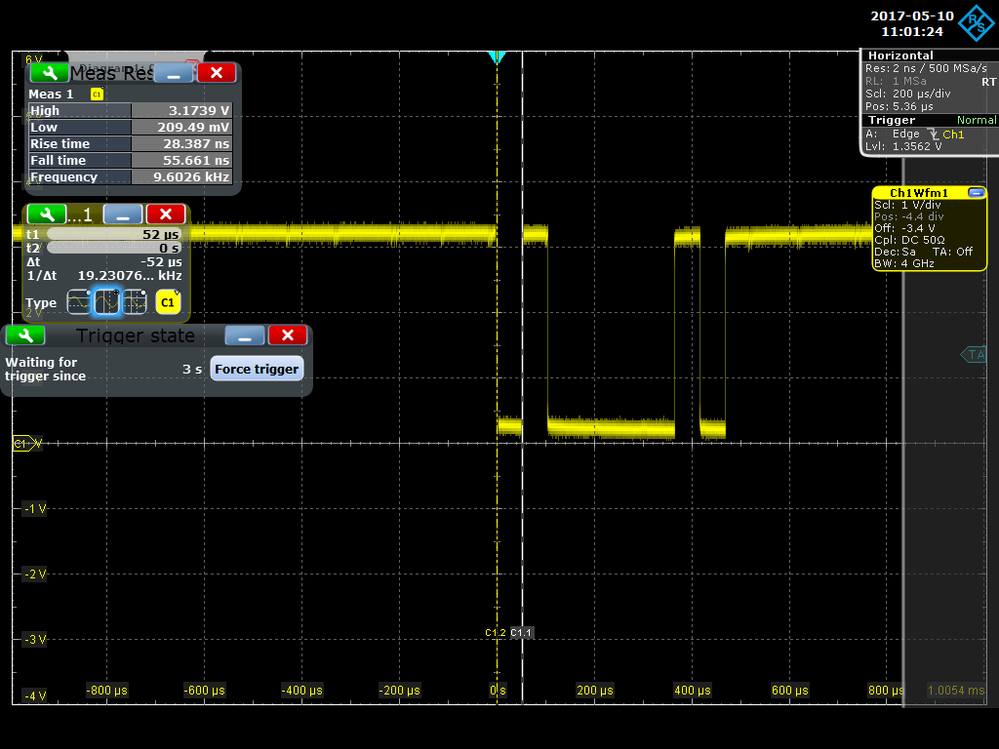

-------Test Case Group 2:  (incorrect baud locking cases), with BRKs
Step1:    DCE(19200)  send Rx single "A"       (Screenshot_2017-05-10_06_110124.png)
Step2:   UCC7   saw  1 Rx: 0x1c
     0x26278040 0x1810 0x0001 0x2627b000 0x1c E:0 W:0 I:1 C:1 A:0 CM:0 ID:0 AM:0 BR:0 FR:1 PR:0 OV:0 CD:0 ERROR
        UCC7 also saw an unexpected BRKS event which does not exist according to the scope
     ucce=0x60[AB:0,IDL:0,GRA:0,BRKE:1,BRKS:1,CCR:0,BSY:0,TX:0,RX:0]
Step 3:   DCE(19200)  send Rx single "A" again (Screenshot_2017-05-10_07_110302.png)
Step 4:     UCC7 saw 2 Rx: 0x1c 0xF8               locked_brgc=0x1203e (locked_baud:390625)  locked baud far away from 19200!
     0x26278048 0x1800 0x0001 0x2627b001 0xf8 E:0 W:0 I:1 C:1 A:0 CM:0 ID:0 AM:0 BR:0 FR:0 PR:0 OV:0 CD:0
    there is no brks:
Step 5:        DCE(19200)  send Rx  "AAAAAAAAAA"
Step 6:         UCC7 saw fc f0 f0 f0  fe f0 f0 f0 f0 f0      note:  there was no errors reported by BD status for receiving  "AAAAAAAAAA"
      note from testing:
         characters ( 0,12,3,8, and all letters except for "D to I, Q, T to Y, a to o, s to z")   triggered uncorrected BRGC locked baud.
