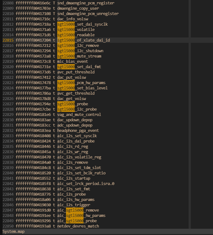

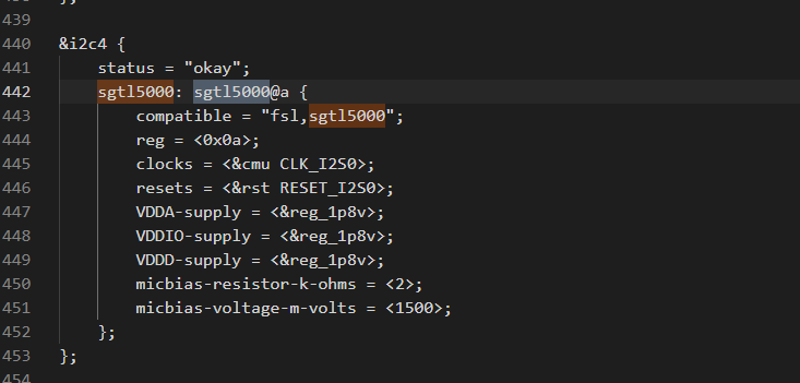

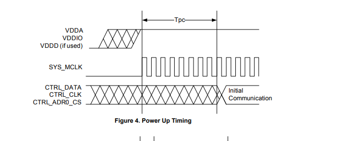

The mclk clock of my sgtl5000 is provided by i2s, and sgtl5000 must go through 8 mclks to establish communication with i2c. However, I found that the registration of my i2s after sgtl5000 caused communication failure between sgtl5000 and i2c. Is there any way to make the driver of i2s before sgtl5000? I have tried to modify the registration priority of the driver of i2s but it has not worked. Here are some information

The sgtl5000 is working ok, but you i2s looks like is not the one that the sgtl5000 need, check the driver currently in the BSP it works.
