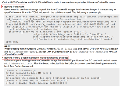

Have you load the m4_0.bin in uboot?
7,771件の閲覧回数
ranjithkumar_kv
Hi Zhiming,
We haven't modified the U-boot source code other than the dts, defconfig and board file changes. We have used "flash_linux_m4" flag for booting with M4 and "flash" flag for booting without M4 in the imx-mkimage compilation.
Ranjith Kumar.

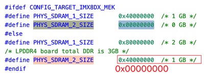

We are using 2GiB of DRAM in our design. Can you please let me know if any guide is available for changing the address?
Ranjith Kumar.
7,735件の閲覧回数
Zhiming_Liu
Hi @ranjithkumar_kv
From the error log, it seems relate to vring and vdev address, but i just calculate the vdev and vring address, there are in range of 2GB.
Maybe this issue is caused by incorrect DRAM definition in Uboot. The Linux still use 3GB DRAM size to map address , this could be the reason about address NULL issue.
You can try to modify  include/configs/imx8qxp_mek.h in Uboot like this.
Best Regards
Zhiming
7,725件の閲覧回数
ranjithkumar_kv
Hi Zhiming,
We think the issue is sorted out once we change as per your suggestion in the mek.h file. Thanks for your support.
Will check with you if any other issue arises.
Ranjith Kumar.
