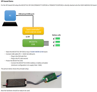

I have purchased FRDM33771CSPEVB  ( IC is MC33771C) development board for battery Management system.
I want to do testing of a battery, Please can anyone help me out how to start with this board
I also have S32K144EVB platform board.

1. Could you please confirm that the hardware is configured as the image below?
2. Have you download and installed the MC33771C/MC33772C (Battery Cell Controller) Evaluation GUI?
Once installed, please go to Info and click on Help. You will be able to review all the steps to run the demo.
I hope this information helps.
David

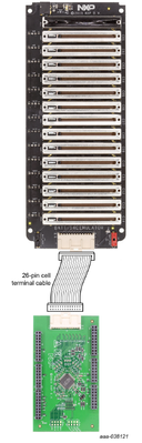

First, I would like to recommend downloading the User Manual (UM11402) from here. Please review the chapter 3.
Do you have the BATT-14CEMULATOR?
The BATT-14CEMULATOR is a 14-cell battery emulator board that provides an intuitive way to change the voltage across any of the 14 cells and four voltage outputs in order to emulate four external NTC. A minimum of 7 cells and a maximum of 14 cells can be monitored.
David

Thanks for connecting, I have already this much of information. Could you please help me out -how to connect the board to NXP design studio software and how to start with an example.
1,447 Views
diazmarin09
David
