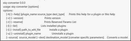

It seems the eIQ Toolkit on Linux must be used through CLI. I've been able to use it in Ubuntu 22.04.5 LTS. As pointed out by @danielchen here, after downloading it you have to setup the environment with:
source /opt/nxp/eIQ_Toolkit_v1.16.0/bin/eiqenv.sh
And you will have access to the main converter tool:
eiq-converter --help
eiq-converter 0.0.0
usage: eiq-converter [options]
options:
    [-h] [--help] [plugin_name source_type dest_type]      Prints this help for a plugin or this help
    [-v] [--version]                             Prints version
    [-r] [--reserve]                             Prints Reserved Params List
    [-l] [--list]                                Lists installed plugins
    [-i] [--install] path_to_whl_file            Installs a plugin
    [-u] [--uninstall] plugin_name               Uninstalls a plugin
    [--source]  source_model [--dest] destination_model [conveter specific parameters]    Converts a model
You will find documentation about how to use the CLI at:
/opt/nxp/eIQ_Toolkit_v1.16.0/docs/eIQ_Toolkit_UG.pdf

danielchen
Hi    deneriz
Can you try to use command line as below?
$ source /opt/nxp/eIQ_Toolkit_v1.14.0/bin/eiqenv.sh
$ eiq-converter -h
