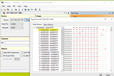

19,204件の閲覧回数
Hello @at-nakano
‘Which tool do you use to communicate with MCU? I can try to test on my side with your tool, so could you please tell more, thanks.
I use Flash Magic test, can read data correctly:
Alice

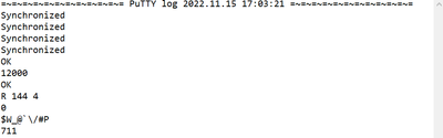

19,157件の閲覧回数
Hello @at-nakano
Could you please take a screenshot about the steps and result on your  terminal software,
it's better includes all the commands you used, and also "If I read data from 528, it works fine.".
Also could you please send a download linker about your terminal, I will install it on my side to reproduce, and then  I can escalate this issue, thanks.
Alice

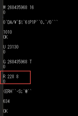

19,144件の閲覧回数
at-nakano
Hi Alice,
Thank you for your continuous support, it really appreciated.
First off, I have successfully read 8 byte of data from address 0xe4.
I'm checking the commands when Flash Magic read 4095 bytes of data from address 0, and use these commands to read the data from 0xe4.
Please see the screen-shots.
Read_228_8_Fail and Read_512_8_Success are the one you requested.
When I issue the command based on "Flash Magic Based", the result is Read_228_8_Success.
Although the issue is seems like solved, I have an additional question.
According to the commands from Flash Magic, I should write and execute data at 0x1000 0200 before read data from first 512 bytes area, but I have not found any document about this condition.
It is much appreciated if you tell me what "W" and "G" commands does, and showing resources and/or document explaining this requirement.
Anyway, I don't think the issue was caused by tool, but in case, the terminal software I used is teraterm, and the download link is:
https://ttssh2.osdn.jp/index.html.en

Hello @at-nakano
1) About "Read_228_Success", I don't think this is correct, because from UM , you can see command G is used to execute a program residing in RAM or flash, it is meaning exit from ISP mode, so after G, all the ISP commands  can not communicate with terminal, so I think there is something wrong with below command R 228 8:
2) I test with LPC1769, as below:
Alice_Yang_1-1668503613744.pngI
I also test with other flash address, sometime it returns 0.
So I think use ISP command communicate with Terminal is unstable, recommend you directly use Flash Magic to read.

at-nakano
Thank you for your support and explanation.
The commands on "Read_228_8_Success" were based on commands from Flash Magic.
Please find attached log, this is original command list of Flash Magic, and as you can see, Flash Magic sends W and G for 0x1000 0200.
On the other hand, the commands I wrote on my first post(see below), were from UM and AN11229, so I think this codes should be works, and yes, this works with LPC4078.
Anyway, I understand Terminal is unstable, and using Flash Magic for debug purose is okay, but I need to implement write/read function on the host of LPC1763 board, so I need right procedure to read from first 512 bytes area of LPC1763.
