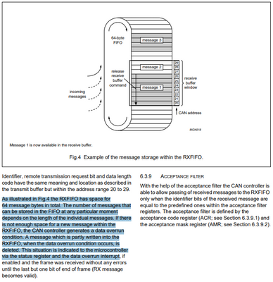

Before the overrun condition was happened or else RX abnormal condition, will the overload frame be issued on the CAN bus by this controller?

Could you please give more information for overrun condition?

unclear your picture,could you please attach/enclose this file here?
