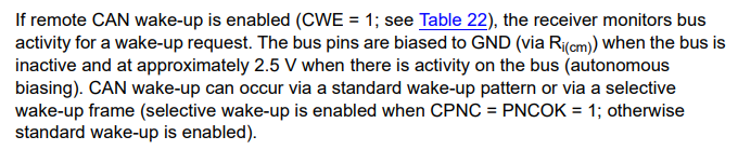

JozefKozon
Dear Phuong Nguyen Le,

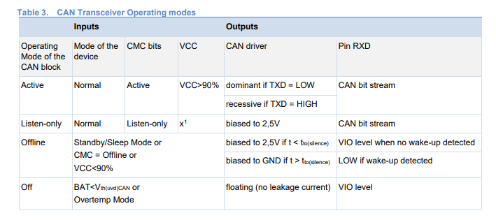

I think you need to set bits PNCOK and CPNC in CAN control to 1 to enable selective wake-up frame.
The CMC bits in CAN control should be set to offline CMC=00.
So I suggest to add a line of code before Enable wakeup feature. 0x4070.
