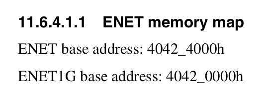

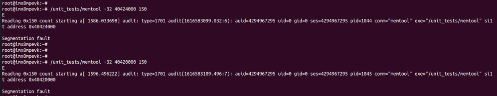

How can we read the ENET register values in i.MX8MP.?
I tried with memtool , but getting seg error.
How can we read those registers?
5,066 Views
jimmychan
The base address of ENET in RM is typo.
The base address of fec is 0x30be0000. (you could find the correct address in dts file https://source.codeaurora.org/external/imx/linux-imx/tree/arch/arm64/boot/dts/freescale/imx8mp.dtsi?...)
And read an undefined register will result in a bus error. It is better to read the register one by one.
e.g. ./memtool -32 30be0004 1   (read the EIR register)
