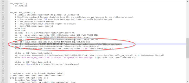

manish-sharma
Hi @Kan_Li ,
Thanks so much for your reply.
Below is the .bb which I took it from package itself and there is no difference between above snapshot (which you have shared) and this one. However, I am seeing the issues during do_package_qa() stage.
MKS
4,765 Views
Kan_Li
Hi @manish-sharma ,
Maybe there is some misunderstanding between us. You may add the following line in the bb file, right in do_install_append():
rm -f ${D}/home/root/${NXP-PLUG-TRUST-MW}/simw-top/sss/plugin/pkcs11/bin/libsss_pkcs11.sojust similar as what we do for libsss_engine.so.
Hope that makes sense,
Kan

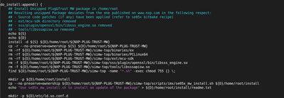

Kan_Li
Hi @manish-sharma ,
The most simple way is adding additional line in the bb file for libsss_pkcs11.so , as the same for libsss_engine.so, please kindly refer to the following for more details.
Kan
