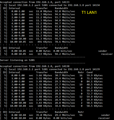

I have configured all the PHYs, but during testing, the speed of T1 PHY1 remains consistently lower (using iPerf3), while the other PHYs perform normally.
I have ruled out hardware issues, as swapping the TRX lines still results in the same problem with the originally affected PHY.
The settings are identical for all PHYs.
Could you advise on what adjustments may be needed?

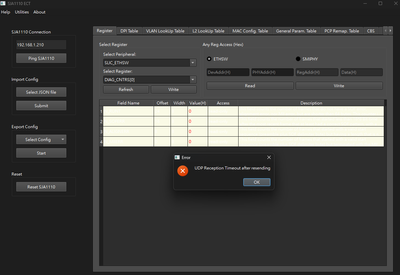

iverson3ya
Hi @PavelL
I used the ECT tool, but I couldn't read the data successfully. Why is that?
2,677 Views
PavelL
Hello @iverson3ya ,
Have you added the ECT server to your project?
Does simple ping from ECT tool work?
Pavel

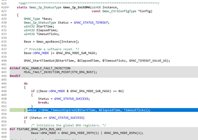

iverson3ya
After using SJA1110 ECT Server 1.0.0, the T1 issue was resolved, but I noticed that the S32K3 is stuck at DMA initialization. What could be the cause of this issue? (Please see the attached image) This problem did not occur before. (I've attached my SJA1110 firmware)
2,536 Views
PavelL
Hello @iverson3ya ,
Please refer to slide 17 of S32K3 Automotive Telematics Box (T-Box) lwIP Example Guide Training Presentation for fix.
Pavel
2,671 Views
iverson3ya
I have successfully flashed the server firmware into the SJA1110, and the ECT is working properly. The issue with the low speed on PHY5 has also been resolved.
Thank you!

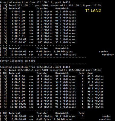

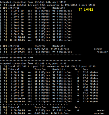

iverson3ya
  • What board do you use?
We designed the board ourselves, but after testing with jumper changes, the issue shifted from PHY5 to PHY6. This confirms that it is a software issue.
  • Who is your link partner during iperf test?
AG35(4G mould) <->SJA1110<-> PC
  • Can you list other PHYs you are referring to? (5,6,7 are internal 100BAE-T1, 4 - 1G SGMII and PHY?, 3 - MII autoneg speed, PHY ?, ...)
PHY 5, 6, and 7 were tested, but only PHY 5 has an issue with a significantly lower speed.
  • Can you share exact results vs port and iperf settings?
Perform a 10-second iperf3 test from PC to AG35
pc to AG35:
iperf3.exe -c 192.168.1.1 -t 10
iperf3.exe -c 192.168.1.1 -t 10 -R
LAN1 = PHY5
LAN2 = PHY6
LAN3=PHY7
When PHY5 is moved to LAN2 for testing, the speed issue remains. However, when PHY6 is moved to LAN1, it works normally
