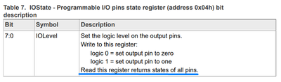

yes, that is correct. You need to poll for checking if the !INT was asserted low by reading the IOState register.

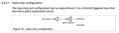

you can connect the !INT pin to one of the GPIOs pin in the SC18IM704. The GPIO pins are configured as inputs after reset.
You can make sure, that the used GPIO is set as input only by setting the PortConfx registers to 00 or 01.
Then you by reading the IOState register of the GPIO pin, you can check if the !INT pin is asserted (LOW).
