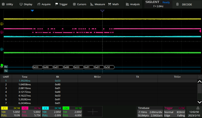

I am trying to access two I2C devices through a SC18IM704. How ever, when I send a write/read command via UART, no signals appear in the I2C whatsoever.
You can find a transaction screenshot (Read register 0x00 in device 0x4D) (yellow-red are UART, green-blue are I2C):
As you can see, I2C is correctly pulled up, but no commands appear in either direction.
For more info, the SC18IM704 does correctly answer to internal register reads/writes.
Is there any known issue that makes the chip behave this way?

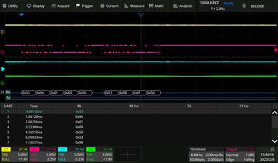

jjvicente
Hi David,
I 've found the root cause of the issue. The SCL pin wasn't correctly soldered (the same pin on three different boards! what are the odds?).
Resoldering again the ICs solved the problem.
Thanks for the support!

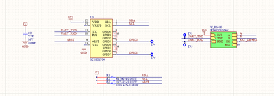

Here I attach an extract of the involved schematic:
I´m converting a RS-485 bus into serial TTL, then it feeds the SC18.
I'm facing other issues regarding the answer timing of the SC18, but I think this issue should be asked in other topic.

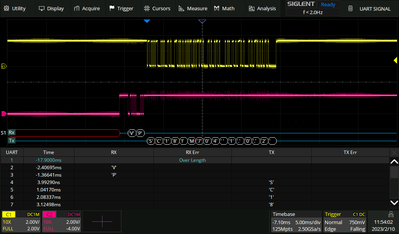

2,726件の閲覧回数
jjvicente
I have confirmed the SC18 is working properly, here you can see a "getID" transaction: 

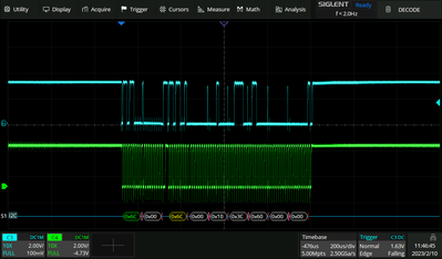

Also, I have checked all the slave I2C-devices are ok, by directly driving the I2C bus using a FRDM-KL43Z. They are up and working:
However, still no data on the I2C via the SC18:
Also I have tried to solder a new SC18, same results.
Juanjo
2,722件の閲覧回数
diazmarin09
Hello Juanjo,
Based on the device ID, it is working properly.
I do assume that the I2C address of your slave device is 0x9A.
As a final test, could you please replace the pull-up resistors? I mean, at SDA and SCL pin. I do recommend using 3.32K value.
David
2,746件の閲覧回数
diazmarin09
Hello Juanjo,
I hope all is great with you. Thank you for using the NXP communities.
Before going forward, could you please share your schematic? Are you using our evaluation board?
