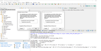

1 Because I don't have the license of the trial version of bbe32, many errors will appear after I cancel the license, how can I get the license of the trial version?

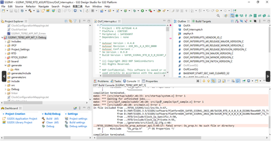

2 After compiling S32R41_TEF82_APP_M7_1, it prompts that the file Os_prop.h cannot be found. I searched my hard disk and still can’t find this file. Which update package do I need to install?
Currently only S32R41_TEF82_APP_M7_0 can be successfully compiled。

For question 1, you should contact your radar FAE.

The file Os_prop.h is generated by "Generate Configuration" operation and located in generate/rtos/Os_prop.h. You may want to check the file existence first and then check RM chapter 5.5 for build steps.

All required installation packages have been installed, and the error message is as follows:
System Generator for AUTOSAR OS/S32R41 - Version 4.4.124
EAR Software - NOT FOR PRODUCTION
NXP(TM) and the NXP logo are trademarks of NXP.
All other product or service names are the property of their respective owners.
(C) Freescale Semiconductor, Inc. 2013-2016
Copyright 2022 NXP
D:\S32R41\S32DS\S32R41_TEF82_APP_M7_1\generate\rtos\RTOS_S32R41.ecvd(12) AUTOSAR/AR-PACKAGES/AR-PACKAGE[SHORT-NAME='RTOS_S32R41']/ELEMENTS/ECUC-MODULE-CONFIGURATION-VALUES[SHORT-NAME='Os']/CONTAINERS: error 3254: Multiplicity check error for '/Os/OsAppMode'
d:\S32R41\S32DS\S32R41_TEF82_APP_M7_1\generate\rtos\RTOS_S32R41.ecvd - 1 error(s), 0 warning(s)

"Generate Configuration" This operation has been operated, and it seems that nothing has been generated.

Normally "Generate Configuration" will generate files under directory generate/rtos. It looks like you have issue in this step. You should check your installed required software.
The BBE32 DSP debugging requires some additional setup beyond the installation of the BBE32 DSP Add-On Package for S32R45. The BBE32 has a different license from the one for S32 Design Studio. This license must be located using the ‘LM_LICENSE_FILE’ environment variable, as instructed within the provided document "{S32DS Install DIR}\Release_Notes\BBE32_DSP_Release_Notes.pdf".

Not sure here. It looks like you are missing RTOS package.
Anyway I am escalating this case to the regional FAE, he will take care of it.
