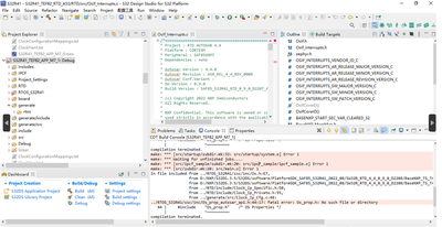

I try to compile S32R41_TEF82XX_DEV_PLATFORM_V1.1, after that I got some errors(My computer is a newly installed system without installing any software unrelated to S32R41_TEF82XX_DEV_PLATFORM_V1.1)。
1 Because I don't have the license of the trial version of bbe32, many errors will appear after I cancel the license, how can I get the license of the trial version?
2 After compiling S32R41_TEF82_APP_M7_1, it prompts that the file Os_prop.h cannot be found. I searched my hard disk and still can’t find this file. Which update package do I need to install?
Currently only S32R41_TEF82_APP_M7_0 can be successfully compiled。

The file Os_prop.h is generated by "Generate Configuration" operation and located in generate/rtos/Os_prop.h. You may want to check the file existence first and then check RM chapter 5.5 for build steps.

All required installation packages have been installed, and the error message is as follows:
System Generator for AUTOSAR OS/S32R41 - Version 4.4.124
EAR Software - NOT FOR PRODUCTION
NXP(TM) and the NXP logo are trademarks of NXP.
All other product or service names are the property of their respective owners.
(C) Freescale Semiconductor, Inc. 2013-2016
Copyright 2022 NXP
D:\S32R41\S32DS\S32R41_TEF82_APP_M7_1\generate\rtos\RTOS_S32R41.ecvd(12) AUTOSAR/AR-PACKAGES/AR-PACKAGE[SHORT-NAME='RTOS_S32R41']/ELEMENTS/ECUC-MODULE-CONFIGURATION-VALUES[SHORT-NAME='Os']/CONTAINERS: error 3254: Multiplicity check error for '/Os/OsAppMode'
d:\S32R41\S32DS\S32R41_TEF82_APP_M7_1\generate\rtos\RTOS_S32R41.ecvd - 1 error(s), 0 warning(s)
3,140 Views
longfeiwang
"Generate Configuration" This operation has been operated, and it seems that nothing has been generated.
3,118 Views
nxf92108
Normally "Generate Configuration" will generate files under directory generate/rtos. It looks like you have issue in this step. You should check your installed required software.
