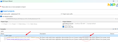

Hi @Shivani_Elavena ,
I think you can refer to the SDK demo "evkbmimxrt1170_power_mode_switch_bm_pmic_rt1xxx_core0" and "evkbmimxrt1170_power_mode_switch_bm_pmic_rt1xxx_core1"
The Power mode switch bm pmic demo application demonstrates the usage of chip's power features with integration of PF5020.
You can download SDK demo by the following link.
https://mcuxpresso.nxp.com/
Wish it helps you.
