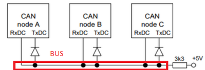

I have a question about the CAN transceiver application.

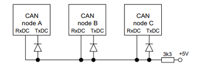

I connect CAN controllers between two MCU without transceiver, like below picture.
[ref to siemens_AP2921.pdf (mikrocontroller.net) ]
And I test CAN frames can transmit on each other correctly.
My question is that, I want to add a CAN transceiver on the 'wired CAN' bus, like below picture, let me transmit and receive CAN frames on the 'wired CAN' by a PCAN device for example. Is it possible to work?

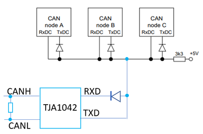

Without transceiver this ^^ is your bus. With transceiver bus is on other side of your transceiver, on CANH and CANL. So I think it should be like this:
Diodes may be not necessary if you can configure your CAN controller TxDC pins as open drain.

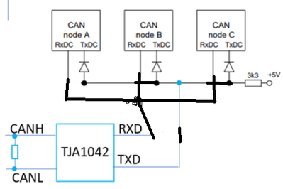

Hi Kef2,
Thanks for your reply, I think your solution will work when the 'wired bus' always connect to the CAN transceiver, am I right? but what I want is that the CAN transceiver is optional, these MCU can communicate with each other without the CAN transceiver.

Either populate transceiver or put a short between transceivers RXD and TXD pads.
