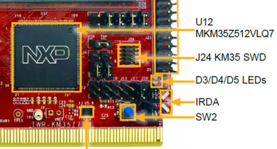

Hello Dear, I am Purchasing TWR-KM35Z75M with Universal Multilink programmer.  Is universal multilink debugger need extra software? If yes than it's paid software or free software. And I want to know, with universal multilink debugger can I debug with MCUExpresso IDE? Is there any support document are available for it?

Hello, thanks for your wait, the universal multi-link can be used with the IDE MCUXpresso as a debugger probe, but the board only for knowledge includes a debugger on the board too.
To use your Universal Multilink need to be connected to the SWD of the target, TWR-KM35Z75M Tower Module (nxp.com) this document shows is the J24 the interface.

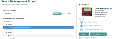

There is no a document that show how to use it with the universal multilink, but there are some examples about code I do not know if this will help you.
Select Board | MCUXpresso SDK Builder (nxp.com)
Let me know if you have more doubts.
