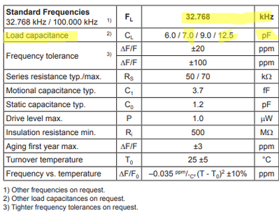

from the hardware point, I see the issue in using external capacitors for the crystal. The PCF85063A has internal capacitors. Selected can be 7pF or 12.5pF. You need to select a quartz crystal with one of these load options and then either left the default 7pF or change it to the 12.5pF.

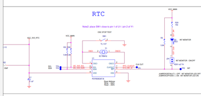

Please check the PCF85063AT-ARD design files attached. In the Bill Of Materials you can find what crystal had been used. It is CM7V-T1A with 12.5pF load capacitance. There is also a 7pF option. Please consider to use this crystal.
Please check the board schematic.

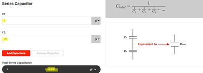

[A] If they have used a crystal with difference capacitance, than default 7pF in the datasheet. Then adding external capacitors could work. E.g. if they have used crystal with required capacitance of 5pF, the internal capacitors are 7pF and they will use 18pF, then overall capacitance will be 5pF.
But why to use additional external components if you don't have to. Saving cost and room.

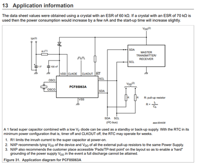

[A] For the recommended schematic please refer to the Figure 31. in the PCF85063A datasheet.
