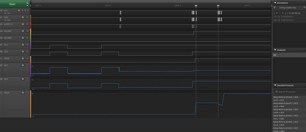

Now we have just tried what you suggested; send normal source command (SourceVbusDefaultVoltage) and just bump up the voltage from 5V to 9V but as soon as the voltage goes up, EN_SRC pin is pulled low. Therefore VBUS disappears and we cannot source high voltage.
I've attached files that describes our problem. It contains 1) a rough HW block diagram of our circuit around PTN chip, 2) scope image of EN_SRC pin and when we try to feed in 9V to VBUS, 3) a log from our MCU. Please have a look.

Not sure why EN_SRC goes off when you tried to source more than 5V. Might be just some setting so I need a full I2C trace to figure this out.
1. EN_SRC should not automatically goes low when you source more that 5V. If Voltage alarm is enabled then there will be an interrupt to TCPM. Not sure why EN_SRC goes off when higher voltage is sourced through the same FET. Do you have an I2C for this? Does PTN5110 reports any fault? What is the OVP of the 5090 set to? Can you capture an I2C trace that includes PTN5110N initialization, successful contract and VBUS go off due to EN_SRC being disabled?
2. There is no such register.
3. It does not make sense if both alarm low and alarm high are triggered.
Tomas

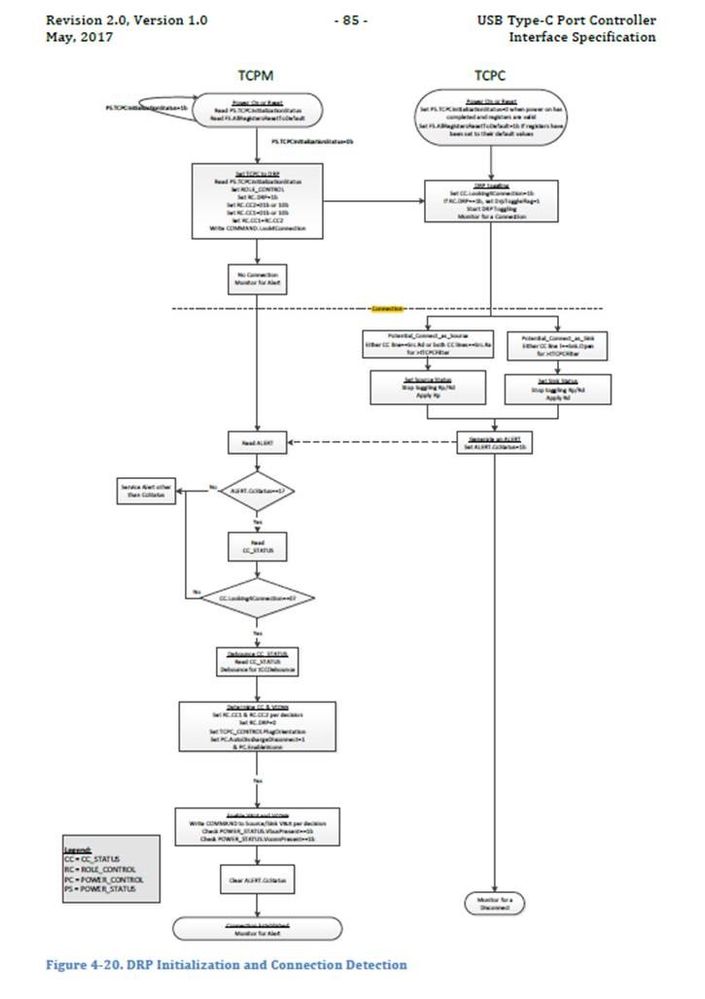

What could really be useful for us is a flow chart or set of instructions that shows exactly how we should transition from 5V to higher voltage. I've attached a flow diagram from another TCPC chip for reference. That will provide us with the guideline of how we should transition from one voltage to the other.
Also could you provide a System Use Case block diagram (just like section 8 of PTN5110 datasheet) for sourcing 5V to 20V using EN_SRC? EN_SNK1 should be only used to enable sinking.

There is no special sequence to source 9V. For a DRP role device we just follow the flowchart (DRP initialization and Connection Detection) from the TCPC spec. Attached is the I2C trace from our board which the code was modified to source 9V about 30mS after sourcing 5V the TCPC command 0x77 (sourceVbusDefaultVoltage). The trace was captured using the logic analyzer from Saleae. You can download the software from Saleae and load up the trace to see what is going on. The trace include the I2C initialization of the PTN5110N, as well as the I2C during connection, sourcing 5V and then 9V. On the trace you can see CC signals as well as VBUS switching from 5V to 9V. EN_SRC remains at logic high and did not drop.
The source FET is not NX20P5090, but it is the NX20P3483. The code sends an I2C command to the NX20P3483 to switch from 5V source to 9V source. The PTN5110N is not involved in the switching of the power rail process, and the process is transparent to PTN5110N. The 9V is connected to the High Voltage switch of this device.
You can use this as an example to compare your code against.
Saleae software can be downloaded from here. The analyzer does come with an I2C decoder and you can see the decoded I2C trace on the lower right hand side of the screen.
