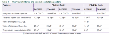

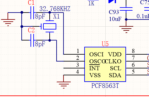

I‘m not sure should I add 1 capacitor on OSCI or 2 capacitor on OSCI ,OSCO pin? Is it 8pF too small?

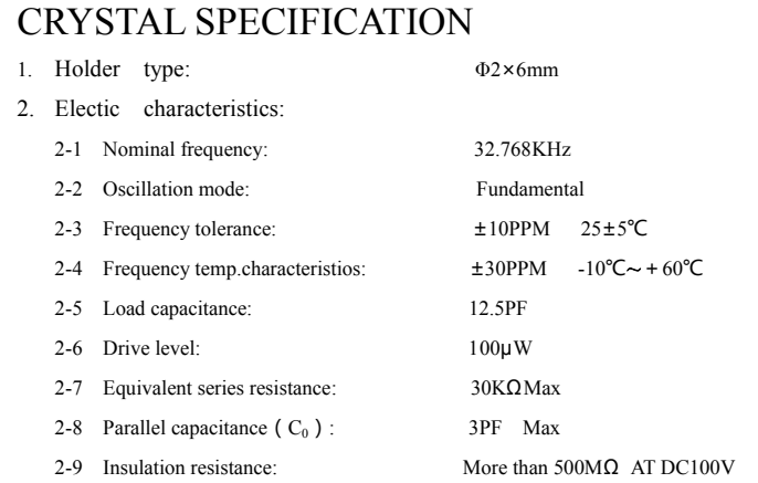

The crystal CL is 12.5pF.And the crystal is nearly close to the PCF8563 pin.
As the Datasheet tips show Cload= [ (Ctrim*Cosco)/(Ctrim+Cosco) ]  should I add 1 external capacitor 22pF on OSCI pin just fine ? OSCO pin no need external capacitor because OSCO has already have internal capacitor?
thanks!

Please refer to below picture mentioned value:
