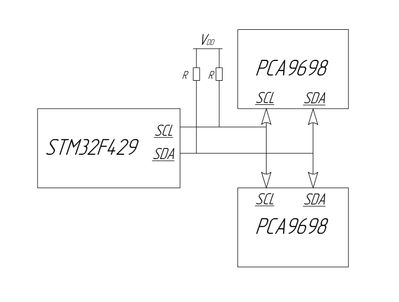

In my case, there are two expanders on the line that should simultaneously update the status of pins according to a STOP state. The documentation states that access to each circuit must be accompanied by the RESTART signal, and there must be a final STOP signal. However, in my case only the second expander is updating the pin status, while the first one is ignoring it. It seems that the first expander does not see the STOP signal.

 Schematic

guoweisun
HI Sergio0703
1: Please share with your schematic.
2: please also catch some waveforms for your test issue and show the IIC signals.

guoweisun
Please follow below steps:
Example 2: More than one PCA9698 is used on the I2C-bus and all the outputs need to
change at the same time.
  • OCH bit (Mode Selection Register, bit 1) must be equal to ‘0’ in all the devices.
  • The master device must access the devices one-by-one.
  • Access to each device must be separated by a Re-START command
  • When all the devices have been accessed, the master must generate a STOP
command.
  • At the STOP command, all the PCA9698s that have been accessed will update their
Output Port registers that have been programmed and change the output states all at
the same time.
1,037件の閲覧回数
Sergio0703
Everything was done according to the documentation, which is what the waveform shows. However, the first expander (before RESTART) does not see the STOP sent after the message to the second expander. I haven't found any contradictions in the I2C specification, so I don't understand the reason.

guoweisun
1:For your test procedure please list clear steps by steps below and catch the waveforms:
command.
2: You can give the more detail schematic.
