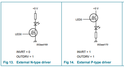

Can I drive LS MOSFET a attached herewith? I am concerned about whether all LED channels are sinking pins.

We wan to drive solenoid like this, it it possible to drive like this

Hi Labib,
yes, it should work. There is an example in the PCA9685 datasheet, in the page 29. using external MOSFET to drive LEDs, with required bit settings. I guess you can also use it to drive solenoid.
With Best Regards,
Jozef
