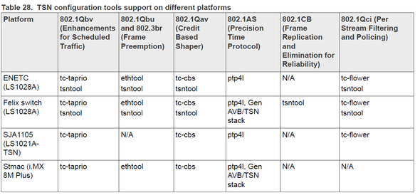

yipingwang
Please refer to the following table for LS1021ATSN support features in Software.
