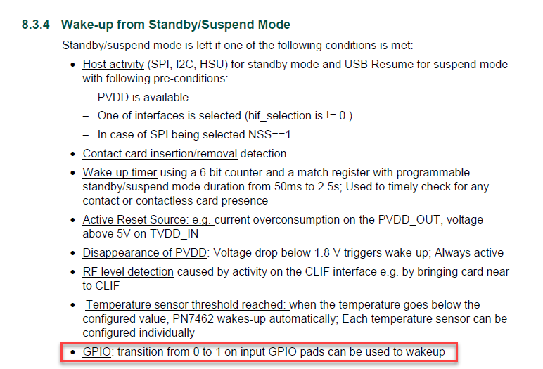

I am using PN7462 (EVK). I want to wake up my board from sleep mode.
I am using the following code to enter into sleep mode. After Executing the following API board is not responding.

If I configure GPIO2 as a active high I am able board is going into sleep and wakeup on rising edge on GPIO2.
//As phhalPcr_Init clear wakeup configuration init GPIO2 in input
phhalPcr_ConfigInput(2, true, true, true, false, false, false);
//PullDown GPIO2
phhalPcr_ConfigPuPd(2,false,true);
Can you please let me know if I have misconfigured or remaining to configure?

Hi @pratikyadav ,
I am sorry, but seems only a transition from 0 to 1 can be used as a wake up event, please kindly refer to the following for details.
