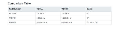

I want to use NTB0104 as a SPI level shifter. You have mentioned that we cant use this IC, some pin in one direction, while others in opposite direction. I am little bit confused. According to this site https://www.nxp.com/products/interfaces/ic-spi-i3c-interface-devices/ic-voltage-level-translators/du...  we can use NTB0104 in SPI application.
also in datasheet;
They give us one cell configuration. As I understand, each data line can be any direction.  In SPI; SCLK,MOSI,CS in one direction, MISO is in another direction. Could you help me: Can I use one NTB0104 for SPI connection.
Thank you
