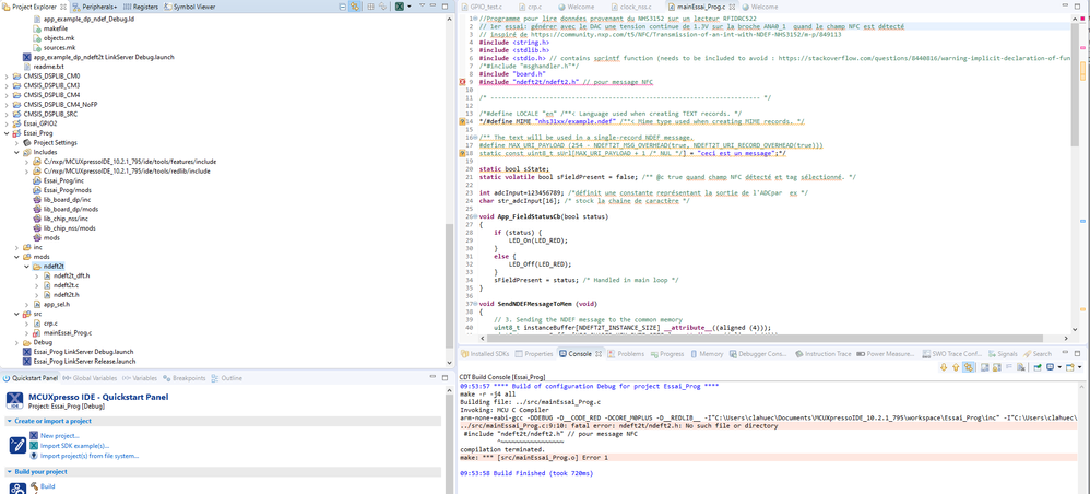

I'm using an NHS3152 evaluation board (with LPC-Link2 board).
I'm trying to use the NFC communication. I used parts of codes I found on the community forums.
I have it seems a set up problem as there is no link to the ndeft2t/ndeft2.h. When I build or debug my short project, I have this error :
09:53:57 **** Build of configuration Debug for project Essai_Prog ****
make -r -j4 all
Building file: ../src/mainEssai_Prog.c
Invoking: MCU C Compiler
arm-none-eabi-gcc -DDEBUG -D__CODE_RED -DCORE_M0PLUS -D__REDLIB__ -I"C:\Users\clahuec\Documents\MCUXpressoIDE_10.2.1_795\workspace\Essai_Prog\inc" -I"C:\Users\clahuec\Documents\MCUXpressoIDE_10.2.1_795\workspace\lib_board_dp\inc" -I"C:\Users\clahuec\Documents\MCUXpressoIDE_10.2.1_795\workspace\lib_chip_nss\inc" -I"C:\Users\clahuec\Documents\MCUXpressoIDE_10.2.1_795\workspace\mods" -I"C:\Users\clahuec\Documents\MCUXpressoIDE_10.2.1_795\workspace\Essai_Prog\mods" -I"C:\Users\clahuec\Documents\MCUXpressoIDE_10.2.1_795\workspace\lib_board_dp\mods" -I"C:\Users\clahuec\Documents\MCUXpressoIDE_10.2.1_795\workspace\lib_chip_nss\mods" -include"C:\Users\clahuec\Documents\MCUXpressoIDE_10.2.1_795\workspace\Essai_Prog\mods\app_sel.h" -include"C:\Users\clahuec\Documents\MCUXpressoIDE_10.2.1_795\workspace\lib_board_dp\mods\board_sel.h" -include"C:\Users\clahuec\Documents\MCUXpressoIDE_10.2.1_795\workspace\lib_chip_nss\mods/chip_sel.h" -O0 -fno-common -g3 -Wall -c -fmessage-length=0 -fno-builtin -ffunction-sections -fdata-sections -mcpu=cortex-m0plus -mthumb -specs=redlib.specs -MMD -MP -MF"src/mainEssai_Prog.d" -MT"src/mainEssai_Prog.o" -MT"src/mainEssai_Prog.d" -o "src/mainEssai_Prog.o" "../src/mainEssai_Prog.c"
../src/mainEssai_Prog.c:9:10: fatal error: ndeft2t/ndeft2.h: No such file or directory
#include "ndeft2t/ndeft2.h" // pour message NFC
compilation terminated.
make: *** [src/mainEssai_Prog.o] Error 1

Here is an imùage of my MCUXpresso
I fail to see why it does not find that file

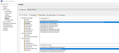

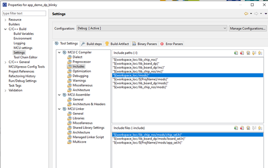

please check the project properties.  the include path,

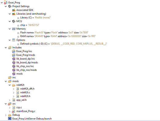

Dear Daniel,
ok I have the paths listed in your picture (see image below)
One of the already included the ndeft2t files ("${workspace_loc:/modes})
nevertheless, I explicitly gave the the full path  the files.
I also included the files in the Inlude File section.
The error is not the same, in this sense it corrected the initila error).
Here ar ethe errors I now have
Any suggestion?
regards
Cyril

CyrilBZH
Hello Daniel,
I'm not yet familiar with the tool MCUXpresso.
I'm certainly missing a link, a path to the ndeft2t.h file. But looking at my project explorer you can see that I have the ndeft2t folder listed in "mods".
Maybe I need it elswhere. but don't see where / how to add it. If you can enlight me...
best regards
Cyril

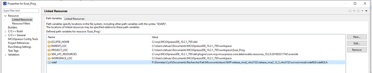

CyrilBZH
ok,
I added that line:
to provide a path where the ndeft2t.h file was.
it seems to have done the work, I don't have the error anymore.
Cyril

danielchen

CyrilBZH
Hi Daniel,
ok, I now have things working. The way I included the ndeft2t in my project was not correct.
