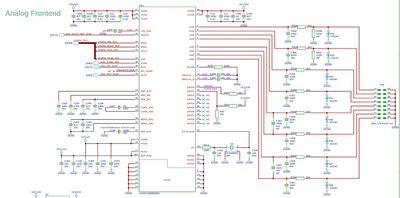

Also, something that is worth commenting, is that I am using TQ System MBa117XL as my development board, which includes the NAFE to handle analog signals, and in the BSP, a driver for the NAFE and an example to read voltage in 4 channels, which is the one I have modified to do the read from AI1P to GND and the voltage excitation from channel 2.

3. I don’t have the TqSystem schematic, but I suppose it is similar to NXP suggested schematic. If so, there is a series resistor of 2.4k (see schematic below) which creates a voltage drop when you use the same pin for VIEX and voltage reading. The value you get should correspond to 2.4k+1k.
Of course, when you measure the voltage manually, you just measure the voltage across the 1k resistor, while the chip measure the series between the two.

Assuming signal path in your board same as NAFE EVB, as explained before, ADC read back will be 750uA*(2400+1000) = ~2.55V compared to DMM measured at the edge connector (J83-pin2) or test hook AI2+ i.e. 0.750V (depends on resistor accuracy and NAFE configuration).
Now if the ADC measurement is not correct, two things to check the Gain (and corresponding Cal pointer) is set based on expected 2.55V and not 0.75V. Also please check that 250 Ohm jumper is off (which doesn’t seem to be the case) as your edge connector measurement of 0.73V close to the expected across 1K rather than 250||1K Ohms.

Secondly, I've firstly looked for the schematics of the TQ board, and as you correctly supposed, the 2.4 k resistor exists in the configuration. Here's a screenshot of the schematics of the analog part, where the NAFE is installed, for you to know:

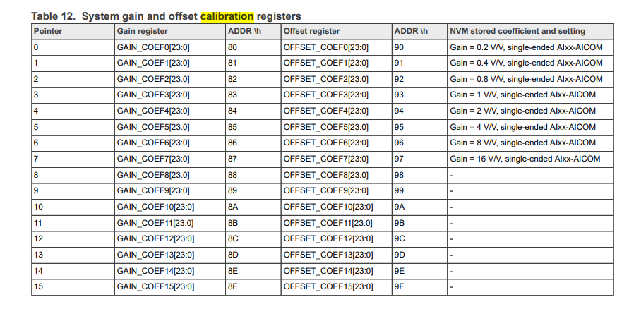

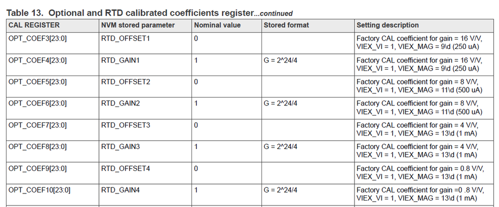

The absolute precision of the excitation current is not a key parameter with NAFE13388. This is because we provide calibration coefficients dedicated to resistance measurements (see Table 13). By using these coefficients the imprecision of the current value is compensated by the voltage channel reading. You should get a total accuracy of around 0.1% in the resistance measurement (of course using different pin for VIEX and Voltage reading).
In order to use these coefficients, you should copy the chosen gain/offset pair (for example: the OPT_COEF7 and OPT_COEF8) in one of  empty registers of Table 12 (for example: GAIN_COEF8 and OFFSET_COEF8) and select this calibration couple (pointer #8 in this example) when doing the conversion in the selected logical channel. Of course, configure the logical channel with the same setting of the calibration pair in terms of Gain and VIEX value (4x and 1mA, in this example).
If needed, another possibility, is to perform a two steps calibration on your board and calculate your own offset and calibration pair. This will provide a much better accuracy results because all the parasitics of that PCB will be compensated too.
