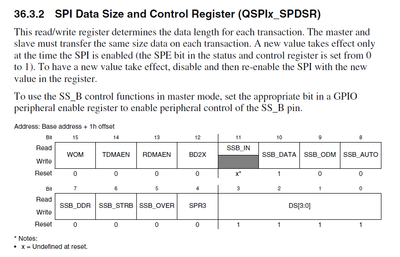

I couldnt find any configuration for timing CS pin like configuration of SPC series PowerPC controller on CodeWarrior. I need this because When I set CS pin end of sending dummy data, Pin is getting high during data send. Due to this reason, I faced with problem which getting data from SPI line. Should I solve this problem by setting CS pin after getting data. Is there any register for timing of CS pin. Thanks in advance for precious supports.

when you configure the SPI in master mode, the /CS signal can be driven automatically or drive as a Gpio pin.
If you want to drive /CS automatically when the SPI transfer data, pls configure the register.
You should configure SSB_DDR=1, SSB_AUTO=1, SSB_ODM=0, SSB_STRB=1 if you want the SPI master to drive the SS automatically.

After configuring Microcontroller as following your decription, The CS pin is pulled high after each byte. But I want the CS pin keep low until the last byte transfer is completed. How can i solve this problem?

Following picture is describe my problem. Other microcontroller IDE has configuration to keep cs low pin until last data byte transfer. Such as S32  PCS continuous checkbox.

I have checked the spi timing in the attached picture, obviously, the waveform is correct, the /CS low interval covers the data transfer.
If you do want to clear the /CS until all data are transferred, you can use any GPIO pin or just configure the /CS pin of master spi as GPIO output mode, not all the peripherals pins are multiplexed with GPIO. First of all, just configure the /CS pin as GPIO output mode, before you transfer any data, clear the GPIO, after the transfer is over, set the GPIO pin.
